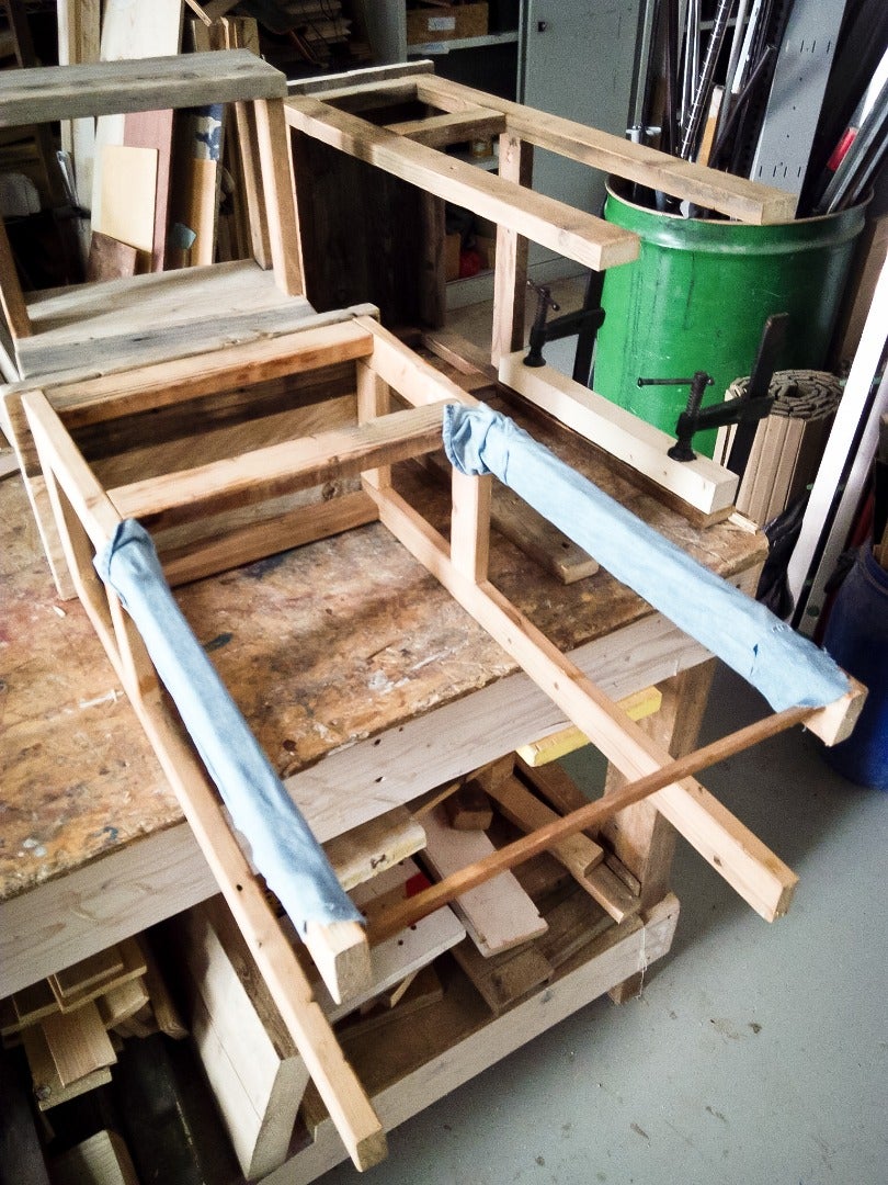

Step 4: Gluing
Glue added, you have to keep pieces strongly pressed together, at least for one or two hours, better more. Use clamps or belts.
Pay attention that every connection is making 90° angle. Otherwise you have to stretch a cord to force pieces during gluing process.
This method is very simple, check diagonals and hook the cord on the longer one, then place a little wood bar in the cord and twist it until the diagonals are of equal dimensions.

Step 7: Straightening Out
To straighten out crooked legs you can wrap them in wet clothes, force them with clamps in the opposite direction and wait some hours or one day.
