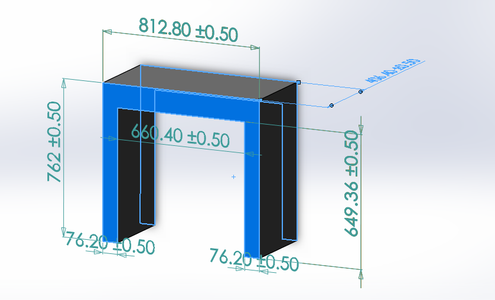

Step 2: Designing
Designing is the important part before creating any wire frame or model for the project.
I have designed this table in solid works according to my required dimensions.
As i have less space in my dorm room so i have kept the size of study table really compact , Which is :
Height : 30 Inches
Width : 32 Inches
Depth : 16 Inches
I have attached some images of solid works so that i can get an idea of the finished product to look like.
It's a convertible table which can get converted into a dinning table from study table.
Dimensions of dinning table
Height : 30 Inches
Width : 32 Inches
Depth : 44 inches
So we have increased the depth of table by 28 inches , it can be understood by the drawing images attached.
We have just used the channels to expand the depth of table, its really amazing and fits gud in my dorm room.
We will increase the depth of the table by using channels and will attached the channels from both the sides of table, the middle portion which will remain empty will be covered by the extra board which we will hang in front of the table.

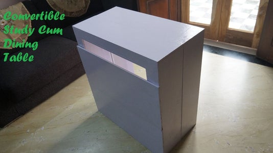

Till now our table have taken a shape of a study table but when we extend it there is nothing in between, so to cover that portion we will take two board pieces of 14 inch x 30 inch and keep these pieces on the channels.
Here you go for the dinning table. Hope u like it
Now we will attach the magnetic latch to the table so that it can attach the extra 14 inch x 30 inch pieces with it.
This is the easy process, in this process we just need to keep the board panel in a horizontal way attached to the base of the table and mark the position for the magnetic latch on the L portion of the table as we can see from the image.
similarly we will keep the second panel on the top of the first one and do the same process. it;s that much easy.
we will attach the bigger magnetic portion with the table and the iron plate with the board panel.
now your table will look like mine as in the images.
