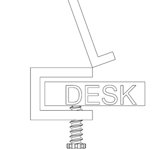

2. Determining how it is fixed :
I choose a piece in "U" shape with a screw to grip the desk.
3. Choosing the way to fold it
I could have chosen different ways, I finally chose the one in the last picture.
Step 2: 3D Modelling
I used Autodesk Fusion 360 for designing my book stand. It allowed me to simulate the folding movement, and it performs very well.
Step 3: Designing the Fastening
As formerly explained, the fastening is shaped as a "U" : the only issue of this is the rigidity, because it can be twisted due to the strength of the screw.
I found a solution which is putting two printed stiffeners, which would slide on the main piece : the fixation is far more rigid with this.
