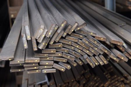

  • flat iron stock 5 x 25 mm
  • flat iron stock 2 x 20 mm

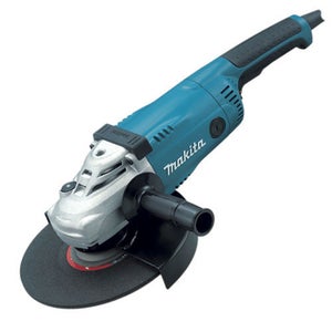

  • assortment of files
  • sanding paper

Cut the square tubing into two pieces one 26 cm long and one 16.5cm long. now cut eight pieces of 6 cm out of the flat iron stock 2 x 20 mm. and weld them onto the end of te square tubing.
Step 4: Hinge
cut four pieces of the flat iron stock 5 x 25 mm with following lengths. weld them together folowing the drawing.

Step 8: Sanding
Cleaning up the welds and grind al of the pieces to size.
