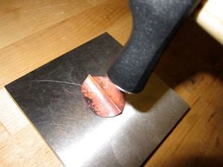

Step 3: Fold Circles in Half
Fold your copper circles in half & hammer flat with rawhide mallet.
Step 4: Hammer Fold
Hammer fold edge with metal hammer.

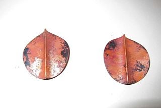

Step 5: Anneal & Quench
The copper is stiff after all the hammering. Therefore, anneal it before going to the next step. You can use a torch such as propane or butane to anneal your copper. I held my pieces over one of the burners on my natural gas stove. When the copper turns dull red - it's annealed. Quench the piece by dropping it in a container of water. Dry thoroughly before continuing.
Step 6: Open Fold & Confirm It
Open up the copper & hammer on the fold.

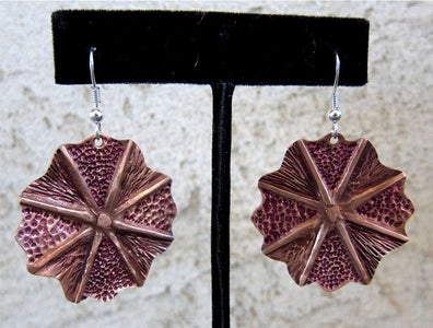

Step 7: Repeat the Annealing & Hammering
You can hammer as many folds into your piece as you like. I chose to do four folds to get a "star" pattern.
Step 8: Add Holes
Add holes for your ear wire. I used a punch for piercing thin gauge metal, but a rotary hand tool (dremel) or drill would work equally well.
Step 9: Final Cleanup
You can lightly sand your copper circles with 500 or 600 grit sandpaper or drop them in a pickle to remove all the firescale (black & red spots). I used a pickle because it's faster. My pickle is made from a super saturated solution of vinegar and sea salt. Finally I added the ear wire which you can buy in the jewelry section of your local craft store or Walmart. I decided to keep going with these earrings, so I cut out parts of the edges, textured them with hammers and stamps, plus used purple Sharpies for color.
