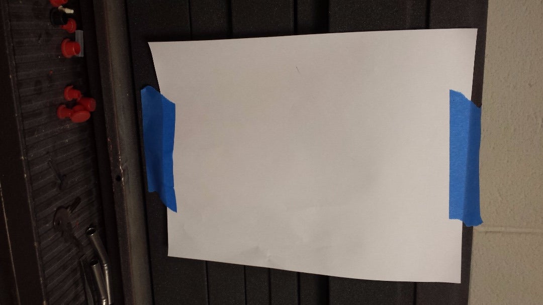

Fire up the fan and check your airflow. You can see this plastic bag is sucked securely to the filter. During my first test with paint I hung a clean piece of paper behind the fan. There was not a hint of paint spray on it when I was done. The filter caught all of the overspray.
