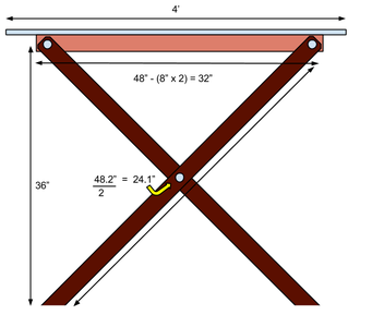

Step 1: Materials & Drawings
- 4'x4' piece of 1/2" plywood (top, mine was cut in half to 2'x4' in order to fit in the car).
- 6 x 2"x4" studs - (for Legs & Frame).
- 2 x 5 1/2" Bolts, Washers, Wing Nuts (For the Legs Middle Support).
- 4 x 4" Bolts, Washers, Standard Nuts (For joining the legs to the frame and providing the rotation/folding of the Legs)
- 8 x Concrete Tie - The joint for our table legs (http://www.homedepot.com/p/Simpson-Strong-Tie-12-G...), mine had the large hole for the bolt/joint and 4 tiny holes for mounting to the underside of the table top.
- 32 x #4 3/4" bolts and nuts (for attaching the joints to the underneath side of the table top).
- 8 x 3/4" Wood Screws (for attaching the table top to the frame).

Step 3: Folding Legs
Measure and cut 1"x1" at one edge to give room for the leg to rotate when in the joint.
Use a Belt sander to then round the edges.
Drill Holes for the bolts. Depending on how high up the joint is from the table top you may need more clearance room to rotate, you can also drill the holes off center from the middle of the 2x4" to allow the leg to rotate easily without hitting the table top.
Attach, test full legs full range of rotation, sand if more rotational clearance is needed.
Measure the location of the cross bolt. The cross bolt will sit halfway down the two legs in the intersection point. You can use geometry to get the right location, it'll be roughly a 45° triangle (depending on the height you want it at) with side being the frame & height, and the hypotenuse being the leg, you'll want the cross bolt to be halfway down that hypotenuse, the drawing on Step 1 puts mine at 24.1" with a table height of 3'.
On the legs, one is positioned outside and one is inside the frame, so you end up with roughly ~2" of empty space in between, I used a small cut piece of PVC pipe to fill that space and provide a snug fit when the bolts are tightened.
