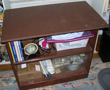

I had a little two-shelf bookcase that my late father-in-law had modified to my specs - I wanted the top to be bigger so I could put my sewing machine on it. The second picture shows the particle board extension from below. It worked for awhile, then life got busy and I didn't sew for like, 15 years. When I decided I wanted to start up again, we had moved to a place where the only room available was a teeny bedroom with very limited space. I thought I could convert the thing to a foldable work table, to get it out of the way when I'm not sewing. My late husband left me a garage full of a lot of tools (most of which I don't know how to use) and some wood - 2x2s, 2x4s, sheets of plywood, some particle board, etc. and lots of things like screws, nails, and hinges etc. I figured I could put this thing together without spending any money except for paint. Funny how these things always only take an afternoon in my mind...
