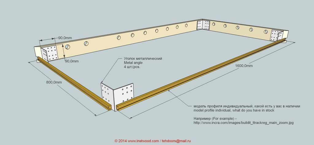

Then I ran across a Russian (I think, do not speak or read the language) site of plans.
http://www.instwood.com/2014/09/blog-post.html
Used google translator to convert to English, they label it folding desk
I watched their videos and decided to order their plans. I figured I could setup 2-4 tools on the folding table and it takes about the same storage room as on dedicated bench. I plan to build the folding bench, one tool stand, and 2-3 storage racks, I need storage for 2-bench grinders, a 6" abrasive saw, 4x36 belt/disc sander, cold metal cut saw, drill press, pantorouter, 4 benchtop router tables, scrollsaw, drum sander, and may also store hand tools, 3 orbital sanders, 4 pad sander, battery circular saw, circular saw, jigsaw, reciprocating saw, and hammer drill. Currently the lawnmower and wheel barrow get moved outside for additional space in the shop. This folding bench would add horizontal surface area in that garage bay.
Step 1: Studying the Plans and Selecting Materials
The plans call for a bench top 1650x850 mm (65x33.5 inches). I have a counter top that is 76x28. Checking the plans I do not see any reason that this counter top will not work. The pivot points will remain the same as the plans, but the size of the bench will change. The pivot points need to stay in the same position so when the table folds it stays in the envelop of the base. Also the outboard legs will be the same distance from the end, with the additional length between the legs. The width does not effect the folding. Also the frame is specified to be 28x100 mm (1-1/8x3-7/8 inch) I have 1x6 (3/4x5-1/2 inch).

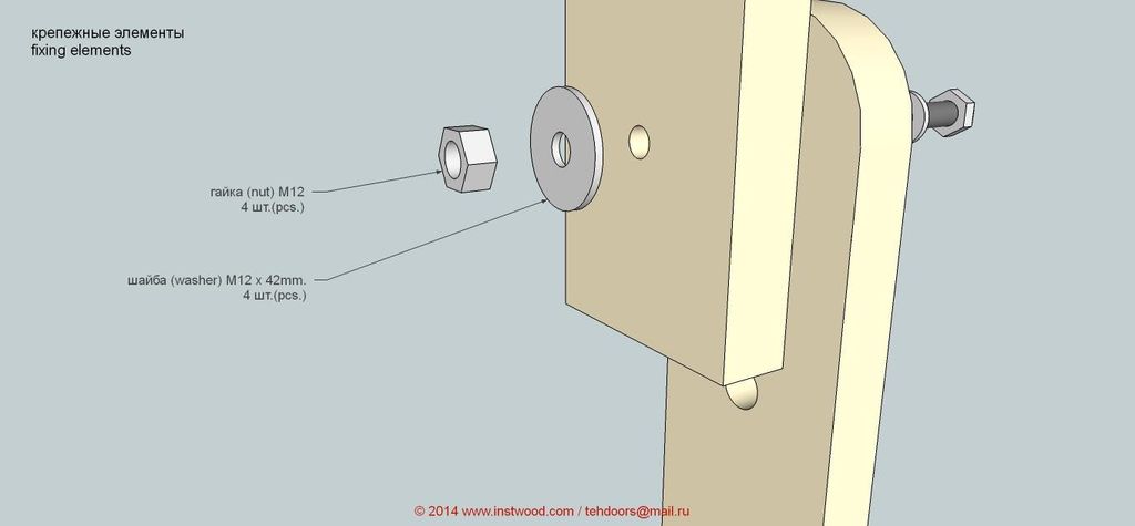

The leg connectors are clamped together for drill of the pivot holes. The holes for the mounting screws are marked on the top part. The screw holes have no accuracy or precision so the holes were marked 1" from the edge. The center screw hole was drill 1/4" and drill through the 4 parts. A 1/4-20 bolt was put in the hole and a nut and washer were tightened to the stack. The clamps can be removed for drilling the 1/2 pivot hole. The hole need to be located accurately so the table will fold properly. Drill all parts at once and mark one edge so that during assembly that edge can be used as a reference when locating the connectors.

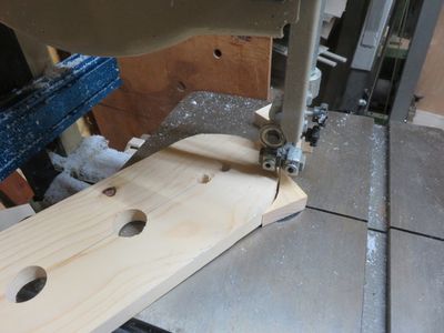

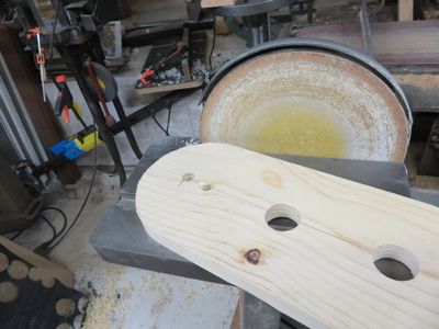

Step 6: Drilling the Legs
The legs are drilled like the connectors. Clamp 2 parts together. Mark hole locations. drill lower 1/4" hole. Install bolt, remove clamps. Now drill the 1/2" and mark one side for installation reference.
After drill the pivot holes the clamping holes 1-1/4" are drill these are not precise and accuracy is not needed. They are just clearance holes for clamping.
Using a compass draw arcs on the top of the legs and then cut the clearance radius and smooth the cut using a disc sander.

Attach the legs to the connectors.
Test the assembly for function, if does not function properly make adjustments accordingly. If holes are drilled incorrectly a dowel can be glued in the hole and re-drilled properly.
The first assembly would not fold up, the end did not clear the mobile base. The top frame on my bench is 40 mm wider than the plans and the mobile leg was installed per the plans. The leg connector was moved 40 mm towards the end, this eliminated the interference of the frame and the base.
