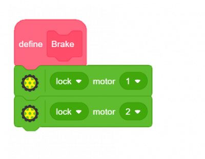

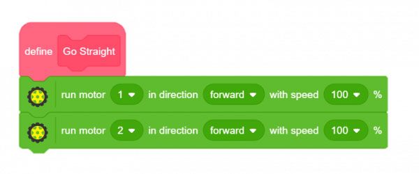

Our robot can execute four actions:
- Go Straight

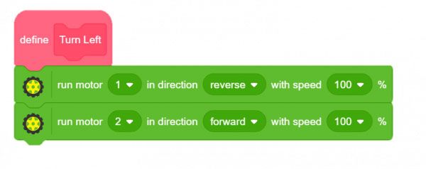

- Turn Left
- Turn Right
- Stop or Brake

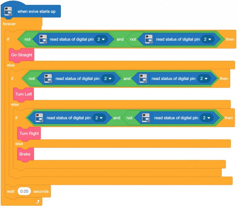

If both the sensors are active (object in front), then the robot should move forward to follow the object. If only the left sensor is active (object on the left), then the robot should turn left. If only the right sensor is active (object on the right), then the robot should turn right. If both the sensors are inactive, the robot should be stopped (brake).
Step 7: Code
Upload the script given below to evive
