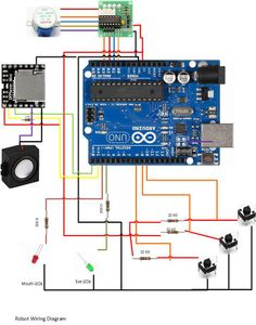

- Once you have all the components listed, follow the wiring diagram seen here to properly wire all the components to the Arduino Uno
- You will make two separate circuits using small breadboards

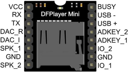

- DF Player board:
- Place the DF Player across the center off the board. Follow the DF Player datasheet pinout to make sure the rx pin goes to the tx pin on the Arduino and vice versa
- Connect the power and ground to power rail on one side and the ground on the other.
- Connect the pushbuttons across the middle. connect one pin to ground
- Using the 22k resistors connector, connect the other side of the PB to power. Arduino connection goes between pushbutton and power.
- Speakers are connected to DF Player as shown in pinout.
- LED Board:
- On one side of the LED board arrange four 330 ohm resistors to connect a rail to power and a wire to connect a parallel rail to ground.
- Repeat this process on the other side for the two eye LEDs

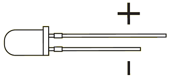

- Bend the led connections so they fit into the female end of your connectors. You will need a connector for the Annode and Cathode. The Anode is connected to the power rail and the Cathode is connected to ground.
- The power rail on each side will connect to LED digital pins 2 and 3 on the Arduino
- Take a cable and connected each the ground rails together.
- Take a wire and connect the ground rail from this board to the ground rail on the DF Player board.

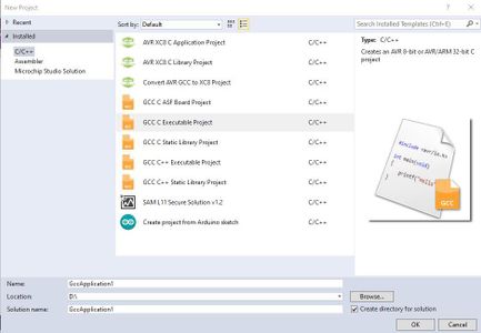

- Once downloaded, Open Microchip Studio and select New Project

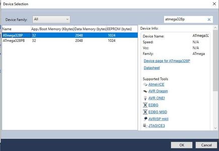

- Select atmega328p as your device
- Copy the code from the main.c you downloaded to the main.c of your program

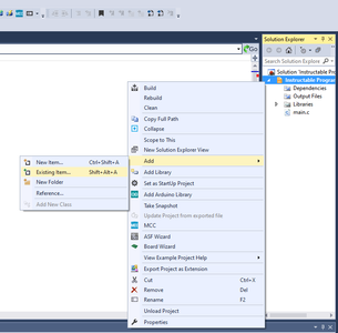

- Store the other .c and .h files in the same folder as your main.c of your arduino program.
- Add the files by right-clicking on your program in solution explorer and select 'Add Existing File'
- You should add the following files to your program: Stepper.h, Stepper.C, serial_MP3.h, and serial_MP3.c

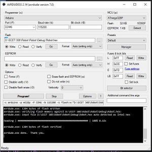

- Using AVRDUDESS select the following options:
(these options might vary depending on the Arduino version of your Chipset)
- Programmer: Arduino
- MCU: ATmega328P
- Arduino Uno (ATmega328p)
- PORT: COMx * x=com port number
- BAUD Rate: 115200

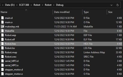

- Flash: *locate hex file produced in the debug folder after successful compile. This should be located where you saved your program*
- After the above selections are made click "Program!" to upload the program to flash
- Go ahead and test it out before assembly. Make sure the push button, stepper motor, LEDs, and MP3 player work.
