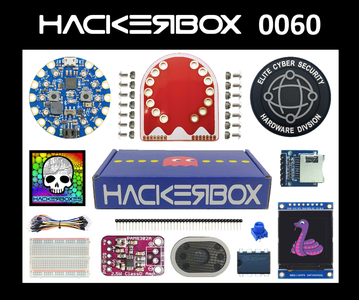

The first one that arrived was "HackerBox60: Playground", the kit included a Bluefruit Playground with loads of functions, a small LCD board, an SD storage slot, and an audio amplifier. The instructions for the board will walk you through building multiple small projects using the components of the kit. You can find the instructable for the full kit here:
