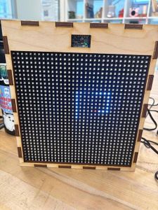

Introduction: Force Drawing on 32x32 LED Matrix
An LED drawing tablet that utilizes the power of the force to sketch images!

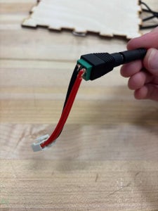

Step 1: Setting Up Power Supply
  1. Strip the wires from 4-pin power connector
  2. Twist exposed wires and slide into adapter
  3. Black Ground wires into the negative port and red power going into positive
  4. Screw adapter tight to create a secure connection

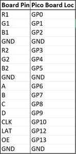

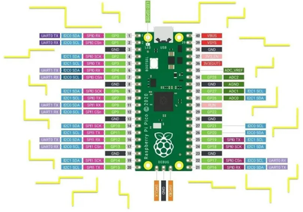

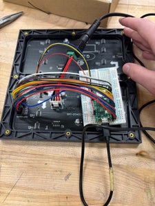

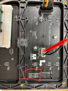

Step 2: Connecting Pico to Matrix
Use the 16 jumper cables to connect the input port on the matrix to the breadboard
The matrix should provide a pin map for the HUB-75 pin locations
Provided is the map for the Pico locations for this specific code

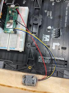

Step 3: Attaching Gesture Sensor
Finally connect the APDS9960 sensor to the breadboard
Attach the Blue SDA wire to GP16 and Yellow SCL to GP17
Black goes to ground
Red to 3v Power
Step 4: Code
Below is the code file to get it running. For proper results, ensure that all libraries are downloaded. The gesture sensor can be a bit finicky so you may have to mess around with its directions to sync with the pixel movements on the matrix.
