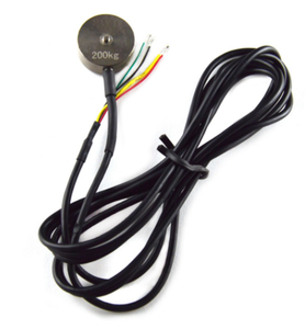

- "Button" load cell 200kg for uniaxial force measurement

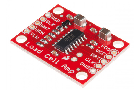

- SparFun load cell amplifier - HX711 essential for force measurement

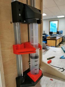

Basically we want to extrude a paste material through a custom made syringe. The material is pushed through the syringe thanks to a piston matching the diameter of the syringe. You can see the extruder on the attached picture. One easily understands all the force needed to extrude the material goes through the piston. This is why we decided to create a custom piston which will contain a load cell to measure the extrusion force.

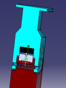

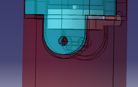

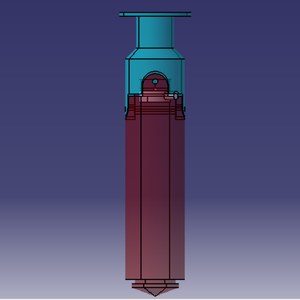

Once our idea was settled, we used CATIA V5 (but you can use whatever software you want) to create the 3D models of our custom piston. The piston is composed of 2 different parts and the button load cell is inserted between them. You can see the 3D models of these parts on the attached pictures. The 2 parts of the piston are attached together thanks to a 4mm threaded rod which fits in the dedicated holes. We added a little bit of play when we designed the holes so that the 2 parts are allowed to move a litlle bit when a force is applyed. This helps for the force measurement and makes it easier for the piston to enter the syringe.
We made a 3D model of the load cell and created an assembly in CATIA to check if everything fitted together.

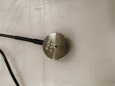

As one can observe by looking at the photo of the load cell, there is a small button on top of it. It is on this part of the load cell that you have lean to measure a force. In our case, it is the upper part of the piston which will lean on it. The issue is that this piston will be printed in PLA and the section of the button is really small. Hence the constraint created by the button of the load cell on the upper part of the piston is really high. In fact it is so high that during our first test of the device, we observed that it had permanently deformed our PLA printed part... We had reached the elastic limit of our PLA. On the attached picture, you can see on the top the underformed part and below it is the damaged part.
To overcome this issue, we machined a small steel part to insert between the button of the load cell and the upper part of the piston. This steel part is sufficiently resistant so that it wont be deformed by the button of the cell. You can see a cut of the last version of the 3D.
You can find attached to this section the last version of the 3D models in stl format

In this project, we seek to measure a force. But do you know what "measuring a force" really means ? In fact you can't measure it directly. One thing you can do instead is to measure a tension by using what is called a strain jauge load cell. It is a device which usually contains 4 strain jauges in a wheatstone bridge configuration. Basically a strain jauge is small strip which resistivity varies with its dimension. This means that when the strip is deformed its resistivity will change. Hence if you apply a current you can measure this difference of resistance (in fact you measure a difference of tension) and with a propper calibration of your device, you can have a measure of the deformation of your load cell and, assuming the deformation is in the elastic domain you just got yourself a measure of the force which is applyed. I won't go into much more details but hopefully you now have an idea of a how a load cell works. If you want to learn more about wheatstone bridge and load cell there are plenty of documentation on the web. Sparkfun has a really good and understandable document on the subject.
Once we knew we were going to use a strain jauge load cell, we had to chose which type of strain jauge load cell we were going to use. As we want to measure an uniaxial force, we chose a "button" type load cell which is adapted to this kind of measurement.

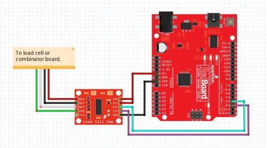

Now that we have chose our load cell we should be able to measure some force by pairing it with Arduino right ?? Well... It is not that easy. As we said, we are going to measure a variation of tension which is proportional to the derformation of the strain jauges of the load cell. The issue is that most of the time the deformations of the strain jauges are reaaaaally low. Hence the tension variation is also really low. This document made by SparkFun gives order of magnitude and more explanations. Basically for a strange jauge having a resistance of 120 ohms, you can expect a variation of tension of about 0.12 ohms... Most of the devices you could use to measure a variation of tension would not detect it.
One solution is to use an amplifier. We chose the HX711 from SparkFun because it is cheap, seemed reliable and is compatible with an Arduino board. We simply had to download the dedicated Arduino library as explained in this tutorial. Now we are ready to build the circuit according to the attached image and we should be able to do some measurements by using the provided code !

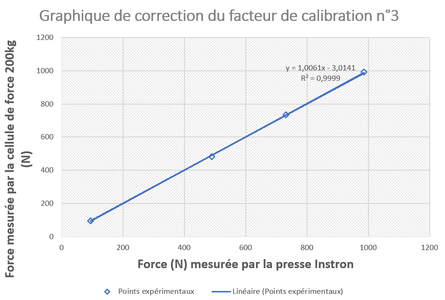

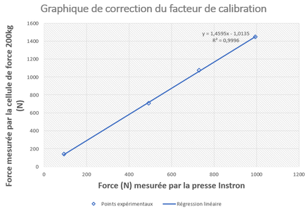

At this point everything was ready. We simply had to do the calibration of our load cell so that the data we record corresponds to the real force which is applyed. To do this we could have used the dedicated settings, scripts and tutorial provided by sparkfun, but we decided to do it differently. At our school we could have access to a mechanical press with a calibrated load cell. We decided to use it to do the calibration of our load cell. You can see a photo of the testing set up attached in this step. We applyed various level of forces on our load cell, average the results of each applied level of force and plot it with the measurements of the mechanical press. We obtain a linear trend and were able to correct the measure in our script. We repeated the process until eventually we get an equation which was really close to "our measure = press measure". That is y = x.

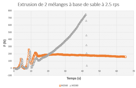

Once everything was put together, the calibration was done and we took care of the friction forces, we could finally do some measurement by combining our force measurement device with our mini extruder ! You can see attached a photo of prototype while our team is using it and a screenshot of a graph illustrating the measurement we made !
