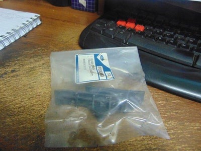

Engine Parts & Consumables:

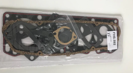

  1. Full engine gasket set (head gasket, sump, timing cover, etc.)
  2. New cylinder head bolts (recommended)
  3. Pistons + rings (oversize if cylinders bored)

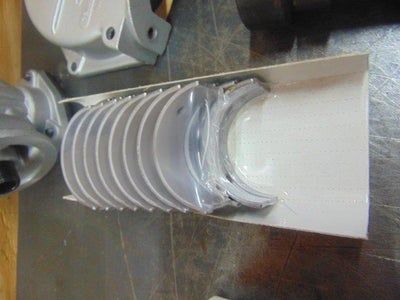

  4. Main bearings & big end bearings
  5. Thrust washers
  6. Timing chain & tensioner
  7. Oil pump (new or reconditioned)
  8. Water pump
  9. Thermostat + housing gasket
  10. New radiator (correct spec for Mk3 1600 GT)
  11. Radiator hoses & clips (You can re-use the clips if they're in good shape)
  12. Core plugs (freeze plugs) set
  13. Distributor 1600 electronic
  14. Distributor cap, rotor arm, points/condenser (or electronic module if upgrading)
  15. HT leads
  16. Air filter
  17. Fuel filter
  18. Fan belt
  19. Exhaust manifold gasket
  20. Standard GT unleaded engine 1600cc (90 bhp)
  21. Oils, oil filter antifreeze fitting gaskets etc.
  22. GT 4 into 2 into 1 Exhaust manifold
  23. Adaptor and cut and shut and Fitting to existing exhaust
  24. ARP Big end bolts
  25. ARP Flywheel bolts
  26. Magnecor lead set
  27. Plugs NGK X4
  28. 1600 GT Twin choke Webber carb 32/36dgv
  29. 1600 GT Webber inlet manifold to suit
  30. Inlet adaptors for engine breather and servo studs and nuts for carb etc
  31. Sports chrome air filter
  32. Water pump
  33. Clutch 3 part to suit type 9
  34. Engine Mounts

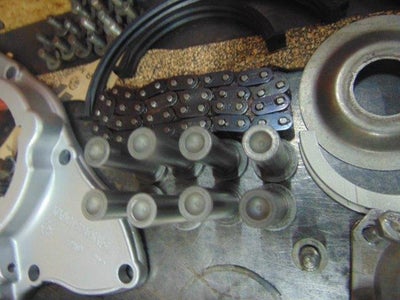

  1. Pistons + rings (oversize to suit bored cylinders).
  2. Main, rod, cam bearings + thrust washers.
  3. Full gasket and seal kit.
  4. New camshaft & lifters.
  5. Timing chain & sprockets.
  6. Oil pump and pickup.

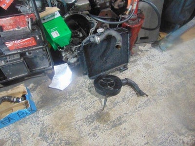

Before the engine is removed, the following jobs need to be done...
  1. Disconnect battery.
  2. Drain coolant and engine oil.
  3. Label and disconnect all hoses, wiring, throttle cable, choke cable, and fuel line.
  4. Remove radiator, fan, and shroud.
  5. Detach exhaust manifold from downpipe.
  6. Remove air filter, carburettor, alternator, starter motor.
Top Tips:
Don't rush a project like this. Take your time to not only get the jobs done right, but to also enjoy the process and don't be afraid to ask for help if you're unsure on something.

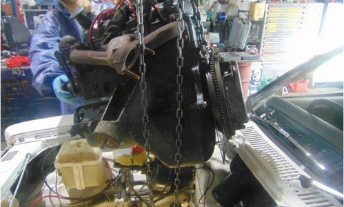

Step 2: Engine Removal:
Separate Engine from Gearbox:
  1. Support the gearbox with jack or block of wood.
  2. Unbolt the bellhousing bolts connecting engine to gearbox.
  3. Remove the clutch slave cylinder (leave hydraulics intact if possible).
  4. Remove the engine mounts.

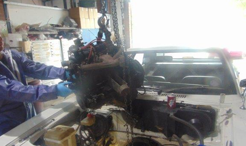

Engine Removal:
  1. Attach hoist chains to lifting eyes on the engine.
  2. Lift engine carefully upwards and forwards, clear of gearbox input shaft.
  3. Remove engine from car and mount onto engine stand.
Top Tip:
An engine can be removed by one person with an engine hoist, but I really suggest to have somebody to help with the process. I strongly advise it so they can check if everything is disconnected and also help if there is a snag while the engine is being lifted.

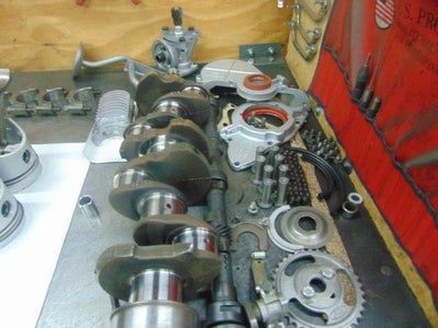

Step 3: Strip-Down and Initial Clean:
First thing to get the show on the road is to take out all of the engine parts and drain all fluids.
  1. Remove the rocker cover, rocker shaft, pushrods.
  2. Remove the cylinder head.
  3. Remove sump and oil pump.
  4. Remove pistons and connecting rods.
  5. Remove crankshaft, bearings, and thrust washers.
  6. Strip timing chain, camshaft, and all remaining ancillaries.
Then move on to cleaning.
  1. Scrape any carbon from piston crowns and head combustion chambers.
  2. Degrease the block, crank, rods, head with paraffin/parts washer.
  3. Knock out the old core plugs and oil gallery plugs.
  4. Brush oilways and blow out with compressed air until spotless.
  5. Chase all threads with tap/die to ensure bolts torque properly.

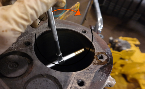

Step 4: Inspect & Measure:
Before we go any further, there are some important observations that need to be done first.
  1. Block: Check for cracks around head bolt holes, water jackets.
  2. Bores: Measure taper and ovality with bore gauge at top, middle, bottom of each bore.
  3. Crankshaft: Measure journals with micrometer, check for scoring.
  4. Rods: Check for bent/twisted rods with jig or machine shop help.
  5. Deck & head: Use straightedge and feeler gauge to check warp.
  6. Decision: Based on wear, order correct oversize pistons and undersize bearings.
With that done, we can now move on to the next step.

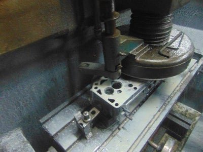

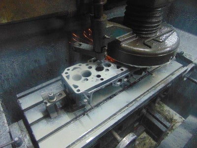

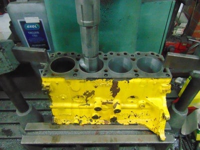

Step 5: Machine Shop Work and Critical Final Clean:
  1. Hot wash the block; shot blast if heavily rusted.
  2. Bore/hone the cylinders to correct oversize; finish hone with a crosshatch pattern.
  3. Skim the block deck if it's warped.
  4. Fit new cam bearings and core plugs.
  5. Grind/polish the crank journals to next undersize if worn.
  6. Resize the conrods; replace little-end bushes if sloppy.
  7. Balance the rotating assembly (crank, rods, pistons, flywheel, clutch).

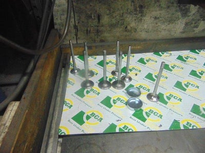

  8. For the head: fit new guides, cut or replace valve seats, lap or replace valves and skim if warped.
Now it's time for the all important final clean up.

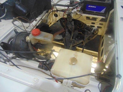

  5. And now is the best time to move over to the car and thoroughly clean out the engine bay.

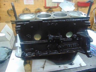

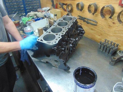

Step 6: Painting the Block:
  1. Mask off the machined surfaces, threads, and bores.
  2. Lightly sand the exterior with fine paper; degrease with solvent.
  3. Apply high-temp primer in thin, even coats.
  4. Follow with 2–3 coats of black engine enamel; allow 24 hours cure.
  5. Remove all of the masking carefully.

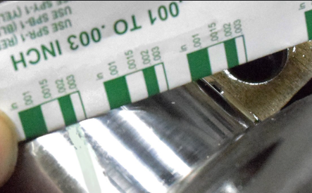

Step 7: Trial Fits & Clearances:
  1. Fit the bearings into block dry, drop in the crank and measure clearance with a Plastigauge.
  2. Confirm the crank end-float using feeler gauge and thrust washers.

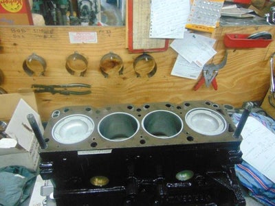

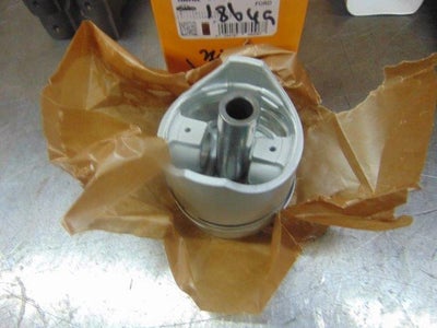

Step 8: Bottom End Assembly and Oil System:
  1. Coat the main bearings with some assembly lube, install the crank and torque caps in sequence.
  2. Fit the thrust washers either side of the centre main.
  3. Rotate the crank. This should spin freely.

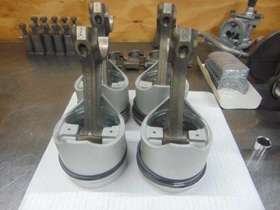

  4. Fit the rings to the pistons (oil ring first, then compression rings, gaps staggered).
  5. Lubricate the pistons and bores, then insert with ring compressor.
  6. Torque the rod bolts; check crank still spins freely after each piston.
  7. Pack new oil pump with assembly lube to aid priming.
  8. Install the pump, pickup, torque bolts, check pickup clearance to sump base (about 6–8 mm).
  9. Now fit the sump with new gasket and thin smear of sealant.

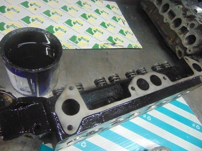

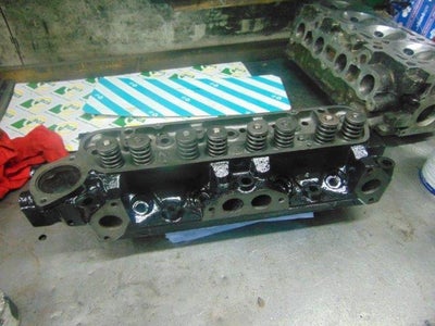

Step 10: Cylinder Head:
  1. Assemble the valves with new stem seals, springs, retainers.
  2. Check the installed spring height and pressure if you uprated the cam.
  3. Place a new head gasket on the clean block deck (correct orientation).
  4. Fit the head; torque the bolts in sequence in three stages.
  5. Fit the rocker gear, pushrods, and set valve lash or lifter preload.

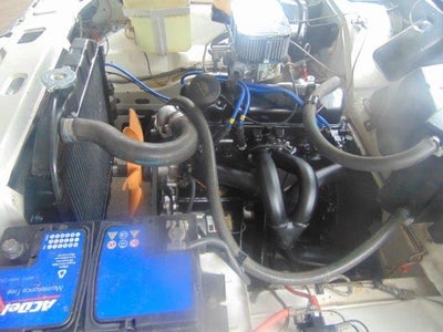

  5. Fit all of the new belts, hoses, and engine mounts.

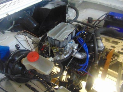

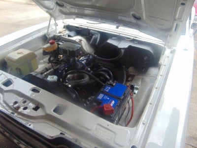

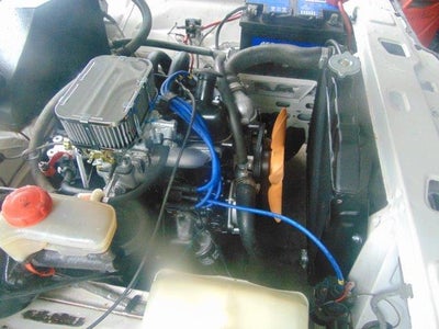

Step 12: Engine Refit:
Clutch & Flywheel:
  1. Fit the flywheel (torque bolts). You don't have to fit a new flywheel, but it is recommended.
  2. Fit the new clutch plate and cover (align with tool).
Engine Refitting:
  1. Lower the engine back into bay with the hoist.
  2. Align the gearbox input shaft with clutch splines.
  3. Bolt the bellhousing to engine.
  4. Refit the engine mounts.
Reconnect Systems:
  1. Refit the clutch slave cylinder.
  2. Reconnect the exhaust system.
  3. Then reconnect the wiring, throttle, choke and fuel lines.
Top Tip:
As with removing the engine, get someone to help with the refitting.

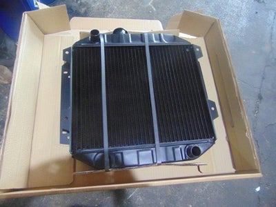

Step 13: Radiator & Cooling System:
  1. Install the brand new radiator with mounting rubbers.
  2. Connect the upper/lower hoses and heater hoses then secure with clamps.
  3. Fit the correct pressure-rated radiator cap.
  4. Ensure the fan and shroud are properly aligned.
Step 14: Pre-Start Setup:
  1. Fill the oil sump with 4L of break-in oil (non-synthetic, high zinc if possible).
  2. Spin the oil pump with a drill via the distributor shaft until oil flows from the rocker gear.
  3. Set the distributor for static timing (about 10° BTDC for initial fire).
  4. Pre-fill the carb float bowl with fuel to save cranking.
Step 15: Cooling Fill Procedure:
  1. Close all the drain plugs.
  2. Pour 50/50 antifreeze/distilled water mix slowly into the radiator.
  3. Squeeze the hoses to expel any trapped air.
  4. With the cap off, start the engine; top up as the thermostat opens.
  5. Fit the cap once the coolant level stabilises, the heater is blowing warm, and there are no more bubbles.
  6. After cooling, recheck the radiator and the expansion tank levels.
Step 16: Post Engine Fitting Jobs:
Carburettor Tuning & Ignition:
  1. Static time ignition at 8–10° BTDC.
  2. Start the engine and warm up.
  3. Adjust the idle mixture and speed (about 750–850 rpm).
  4. Fine-tune the ignition with a timing strobe (10–12° BTDC at idle, vac advance off).
First Fire & Cam Break-In:
  1. Start up the engine, bring it immediately to 2,000–2,500 rpm for about 20 minutes.
  2. Watch the oil pressure gauge (should be 40–60 psi cold).
  3. Also watch the coolant temp; ensure fan cycles, no leaks.
  4. Turn the engine off and let the engine cool.
  5. Re-torque the head if required by gasket type.
Post-Run & Run-In:
  1. Drain the oil and fit a new filter immediately after break-in.
  2. Drive for 500 miles gently using varied throttle and speed, avoid using a constant rpm. Do not do any full-throttle runs or long idling.
  3. At 500 miles: change the oil & filter, then tune ignition timing and the carb properly.
Final Checks:
  1. Check for leaks (oil, fuel, coolant). You can pressure-test the cooling system to check for leaks.
  2. Re-torque the head bolts after heat cycles.
  3. Recheck the valve clearances.
  4. Road test and monitor the temperature and oil pressure.
  5. Recheck the valve lash, torque head and manifolds again after heat cycles.
  6. Confirm the charging system, oil pressure, and steady idle.
  7. Step back, admire glossy black and chrome engine, then accept praise graciously.
