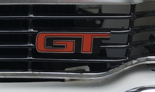

The GT badges are not just for show as when we did the engine rebuild seen in Part 1, we added the 1600 GT Twin choke Webber carb 32/36dgv and the 1600 GT Webber inlet manifold along with the GT 4 into 2 into 1 exhaust manifold, this was a true GT engine.

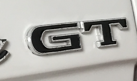

  1. Clean the areas with an alcohol cleaner where the self-adhesive badges are to be places.
  2. Offer up the badges to the bodywork to make sure where you want to place them.
  3. Then peel off the backing paper from the badge and firmly attach to the bodywork.

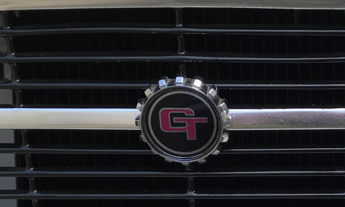

  4. In regards to the 'bottle top' grille badge, this was attached to the grille by 2 screws and a backing plate.

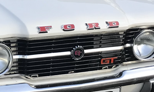

  5. And for the metal 'FORD' lettering, these are press-fit with two lugs on the back of each letter that press into rubber gromets. Place some masking tape along the front of the bonnet/hood where the letters are to be attached and roughly draw out the letters so you are happy with the positioning.
  6. Mark out where the lugs are on each letter onto the masking tape. Then drill out the holes to the size where the plastic grommets will be a firm press fit.
  7. When the holes are drilled, remove the masking tape, insert the gromets and firmly press the letters into place.

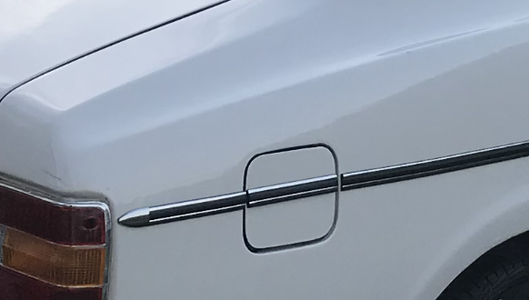

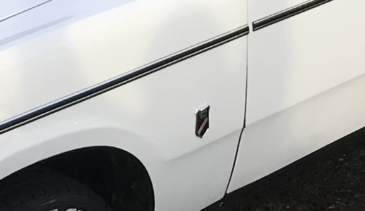

When I got the car, it cam with some black vinyl stripes, but I wanted to replace these with the proper GXL chrome/rubber body panel trims.
  1. Peel of one end of the old vinyl stripes then peel off.
  2. Use an alcohol cleaner with a microfiber cloth to get rid of any adhesive residue.
  3. Pick the line/location of where you wish to attach the new trim. If your car doesn't have any visible body styling lines, use a length of masking tape and attach it to the bodywork just above or below where you want the trim.
  4. Starting from one end of the car, start to remove the backing tape and attach the trim to the car until you reach the other end.
  5. If you are happy that it is straight enough, run down the length of the trim with a cloth applying firm pressure to full stick the trim (careful not to press too hard and risk denting the bodywork).
  6. With a sharp knife, cut through the trim on each side of the doors and the fuel filling flap
  7. Finish off by attaching the trim end caps making sure they are straight.
