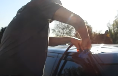

Step 1: Remove the Roof Rack
Use the pry tools and remove the cover
