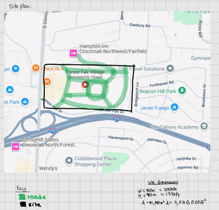

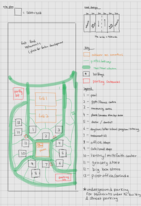

In order to design a solution that was feasible, I did some research. I found many abandoned malls, including the Promenade in Los Angeles, California. However, this site was not feasible as a housing village was developed across the street and that area provided many amenities already. After some research, I found Forest Fair Village, in Fairfield, Ohio. This site was perfect because it was long abandoned with no clear plans for redevelopment. Additionally, the site had some amenities but not many. However, it was near an Interstate, meaning that Forest Fair Village could be easily accessible.
The site dimensions is:
  1. Width: 900.40 m (2,954.06 ft)
  2. Height: 402.56 m (1,320.72 ft)
These dimensions are useful during the site sketch. See the legend in the picture for more clarity on where the proposed housing village would lie.

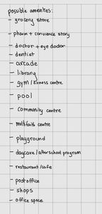

Additionally, by researching 15 minute cities, I outlined some possible amenities Forest Fair Village could include.
Step 3: Drafting the Site Plan

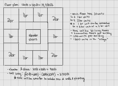

After researching, I began developing the site plan. I choose to have 13 towers, which each have 10 stories of residential living space with two bottom levels of amenities. I sketched the site plan in the attached picture. I decided with a transportation focused road design which included sidewalks, raised bike lanes, and a two way road for cars. Residents also have access to underground parking. Visitors to Forest Fair Village can park in the level parking lots. This design has many trails to enjoy nature, and outdoor recreational facilities.
Note: the second parking lot could be converted to a bus exchange for future development.

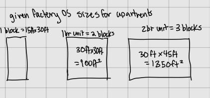

Step 4: Designing the Residential Space
To design the 10 floors of residential living space for all 13 towers, I decided to use factory OS sizes for apartments. This allows for easy construction and building costs. Additionally, since all levels have the same design, this means there is less confusion or building error.

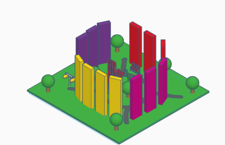

Step 5: Modelling the Design
Do you remember the feeling when you think you could do something easily but it humiliates you when you realize you cannot (yet)?
That's how I felt when I tried Revit for the first time. To be fair, reading documentation and relying on previous CAD knowledge in Vectorworks was not enough. After this project, I will actually learn Revit through video tutorials and hopefully model this design. However, Revit keeps crashing on my laptop, so I believe it is more of a technical issue in using the software.

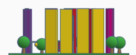

Unfortunately, due to this constraint, I modelled the design in TinkerCAD, which meant the design was similar. In the images attached, it shows what the design may look like. The colours show the different districts that group the amenities. Although simple, this model shows what Forest Fair Village may look like in the future.
