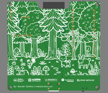

With the NextPCB, we will fabricate custom PCBs for the sensor nodes. These PCBs integrate:
- ESP32-S3 & RP2040 LoRa modules
- Solar & battery management
- Environmental, smoke, and audio sensors
This ensures ruggedness, consistent quality, and rapid deployment of multiple nodes, transforming our prototype into a scalable, field-ready system.

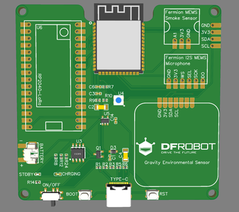

Step 1: PCB Design
Designing the Forest Guard PCB was the very first milestone in this project.
I am not a professional PCB designer, but with hands-on experience in electronics and by studying references from existing ESP32-S3 development boards, I created a custom PCB in EasyEDA that integrates:
- ESP32-S3 as the main controller
- Battery management and charging circuit
- Type-C USB for programming/power
- Headers for plugging in LoRa module and sensors
The PCB design files (Gerber + BOM) are available on my GitHub repository:
👉 Forest-Guard GitHub Repository
To bring this design to life, I got 5× PCBs fabricated and 2× fully assembled boards (with SMD assembly for ESP32-S3, battery & power management, Type-C, etc.) manufactured by NextPCB. The sensors and LoRa modules are later mounted as through-hole or header components.
This combination gave me the flexibility to test multiple prototypes, while the assembled PCBs saved me time and ensured professional quality soldering of fine-pitch SMD parts.

Step 3: PCB Assembly
With the custom PCB manufactured, the next step is to carefully solder the sensor modules and communication hardware onto the board.
Components to Solder
- Gravity: Multifunctional Environmental Sensor
- Fermion I²S MEMS Microphone
- Fermion MEMS Smoke Detection Sensor
- RP2040 LoRa Module with Type-C Adapter
Prepare the Workspace
- Use a clean, static-free surface.
- Preheat your soldering iron to around 350 °C (for leaded solder) or 370–380 °C (for lead-free).
- Have tweezers and flux ready to handle small pins.
Solder Components One by One
- Begin with the smallest modules (sensors) first MEMS microphone and Smoke sensor..
- Than carefully align the Environmental sensor and solder the I²C pins.
- Finally, solder the LoRa module.
- Double-check pin alignment before applying solder. Incorrect orientation can damage the modules.
Continuity Testing
- After soldering each module, use a multimeter in continuity mode.
- Probe between the module pin and the corresponding PCB pad/trace.
- A beep or zero-resistance confirms proper connectivity.

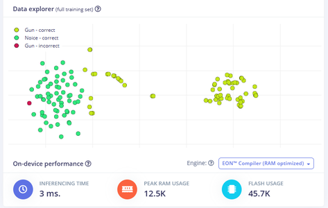

Audio Classification for Gunshot Detection
For this project, we focus on audio classification using the onboard MEMS microphone:
- Data Collection
- Record short audio clips of gunshots and background forest sounds (wind, birds, insects, etc.).
- Upload these samples into your Edge Impulse project.
- Feature Extraction
- Edge Impulse automatically converts raw audio into spectrograms (MFCCs), which represent the frequency patterns of the sound.

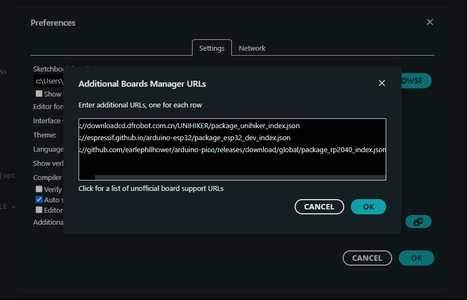

Install the ESP32 Board Package (Board Manager)
- Open Arduino IDE → File → Preferences.
- In Additional Boards Manager URLs, add:
- Click OK.
- Go to Tools → Board → Boards Manager….
- Search “ESP32” and install esp32 by Espressif Systems (latest).
Tip: After install, restart Arduino IDE if the boards list doesn’t refresh.

Step 20: Train Classification Model
With your features generated, it’s time to train the Neural Network classifier that will distinguish between Gunshot and Noise.
- In Edge Impulse Studio, go to the Classifier tab.
- Click Save and Train.
- Training will take a few minutes depending on dataset size.
Default training settings usually work well:
- Number of training cycles: 100
- Learning rate: 0.005
- Processor: CPU
- Architecture: 1D Convolutional Neural Network (recommended for audio)
Results
Once training is complete, you’ll see:
- Accuracy → ~96% (based on your dataset).
- Loss → around 0.25 (lower is better).
- Confusion Matrix →
- Gunshot classified correctly ~94% of the time.
- Noise classified correctly ~100% of the time.
- Metrics →
- Precision: 0.97
- Recall: 0.96
- F1 Score: 0.96
- On-device performance →
- Inferencing time: ~3 ms
- RAM usage: ~12.5 KB
- Flash usage: ~45 KB

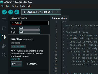

Install Required Libraries
1. Edge Impulse Model Library
- Go to Sketch → Include Library → Add .ZIP Library…
- Select the .zip file you downloaded from Edge Impulse in Step 20.
- This adds your custom ML model to the project.
2. GNSS Library
Download and install the GNSS driver library from DFRobot:
- Install it the same way (Add .ZIP Library).
3. Environmental Sensor Library
Download the library for the multifunction environmental sensor:
👉 DFRobot Environmental Sensor Library
NeoPixel Library
- In Arduino IDE, open Library Manager (Sketch → Include Library → Manage Libraries…).
- Search for Adafruit NeoPixel.
- Install the latest version.

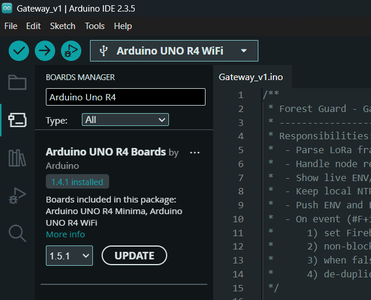

- Make sure the Arduino Uno R4 WiFi board package is installed via Board Manager.
- Install all required libraries as shown in the reference images (WiFiS3, ArduinoHttpClient, NTPClient, DFRobot UI/TFT libraries, etc.).

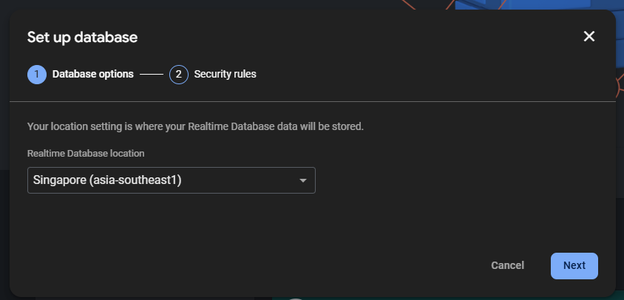

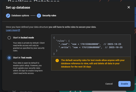

2) Create a Realtime Database
- Left sidebar → Build → Realtime Database → Create Database
- Choose a region close to you (e.g., asia-southeast1 / Singapore).
- For quick testing select Start in Test mode (Firebase allows open read/write for 30 days).
Your screenshots: Region dialog → Test/Locked mode selection ✅
Copy the Database URL shown at the top of the Data tab.

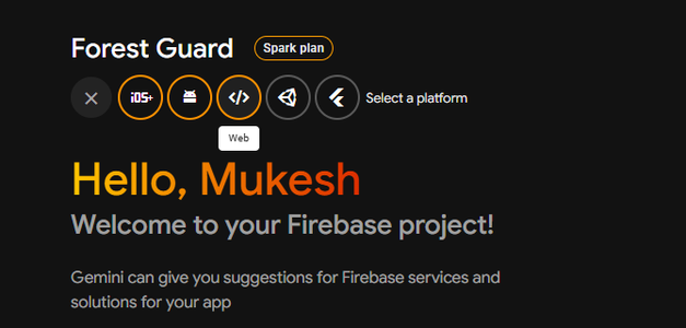

Add a Web App (for your dashboard)
- Project Overview → Add app → Web
- Give it a name (e.g., Forest Guard) → Register app
- On the next screen you’ll see your Web SDK config:
Copy these values into your dashboard (Lovable.dev) settings.

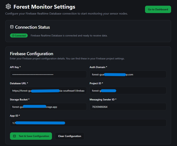

Step 33: Dashboard
To visualize the data coming from the Forest Guard Nodes, I built a custom web dashboard using Lovable.dev. This dashboard connects directly to Firebase and provides both a quick overview and detailed insights into the forest monitoring network.
Setup
- When the dashboard is first opened, it takes you to a Firebase configuration page.
- Here, you enter your Firebase host and authentication key.
- Once saved, the dashboard connects to the database and loads the real-time data.
