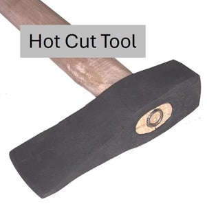

Hot metal can be cut hot (hot cutting) with blacksmith's tools like a hot cutter, hardy tool, or a chisel. This moves the metal instead of removing it and it fun to do. However, if you cut hot metal, do not hammer all the way through your piece or whichever end you are not actively holding will go flying, poking you in the face or setting things on fire. Instead, cut most of the way through, then bend or twist the two ends to sheer the metal.

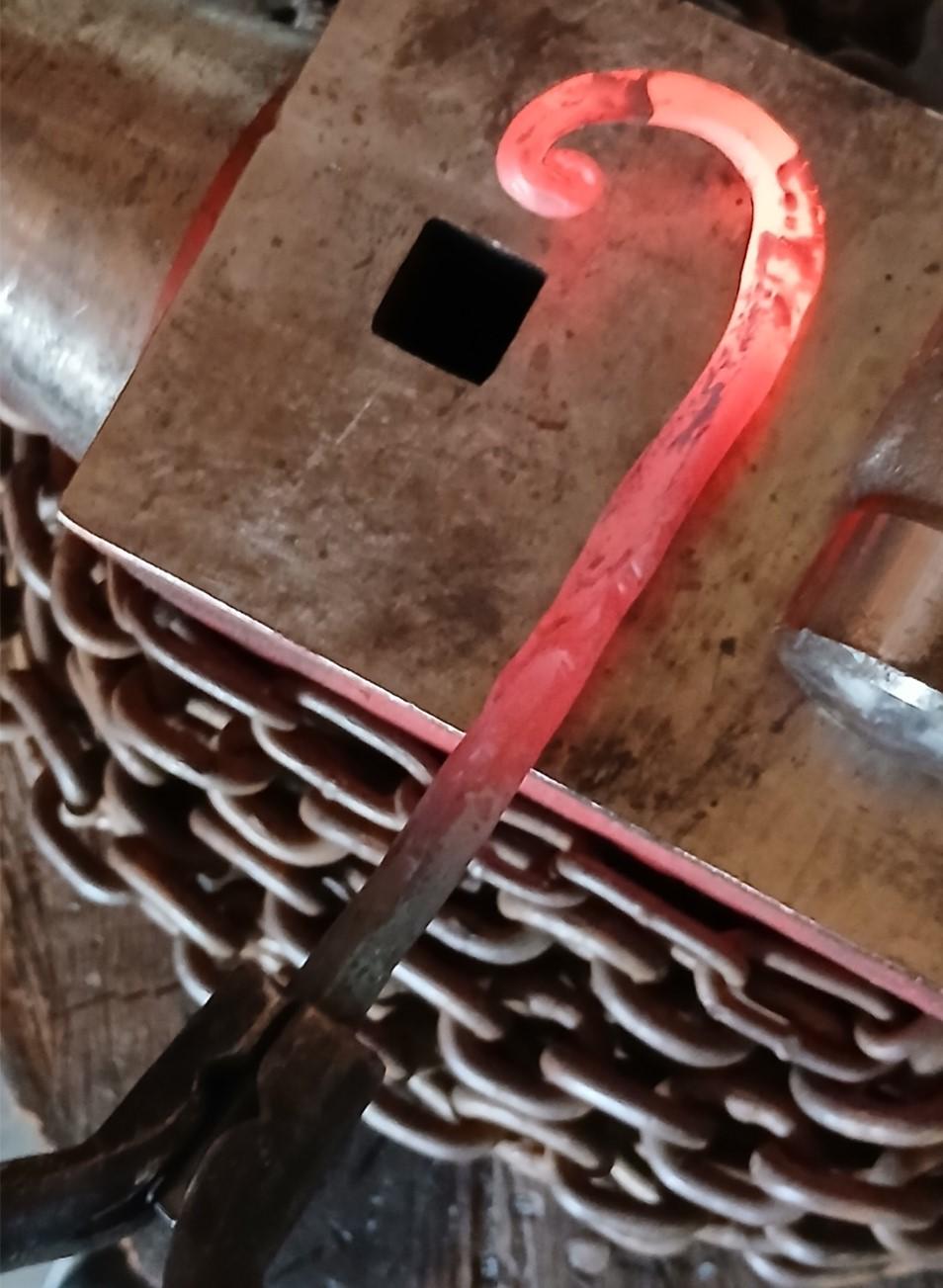

Step 5: Scrolling
The end of a hanger should be scrolled to some degree so there are no sharp edges to catch, cut, or tear whatever you hang on it. Half a scroll should be safe - ten scrolls would look cool but be a lot of work. I do one here. Start by hammering the end of the taper off the edge of the anvil to start the scroll. Once the edge is pointing down, you can do hit it over the edge some more, move it to the horn, or rounded part, of the anvil, or put the piece flat on the anvil and hit the end with glancing blows that pull it inward. Experiment with this to find your preferred method. Once the scroll is done, hammer the hook over the edge of the anvil.

I finished this hook and made it a double hanger - the bottom one for my coat and the top for my hat, but you could stop with one hook and some punched holes to hang it by. Let it cool until it is just barely too warm to hold, then dip it into beeswax (pictured here) or oil. It is okay if it smokes a little; let it cool more if the coating material catches on fire or produces an oily, black smoke. Let it cool until the coating dries, buff it gently with a clean cloth, then hang it up with nails or screws.
The hook pictured here has one extra step - twisting - that is optional, looks nice, and is a good next skill to master after these basic skills.
