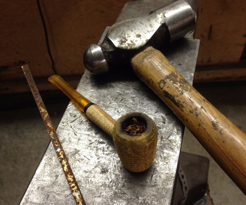

Step 1: Step 1: Gather Your Tools & Material
For this project you'll need basic forging gear:
- hammer
- tongs capable of gripping smaller parts
- hot chisel
- anvil cutoff tool (hardy)
- a forge
- an anvil
and some 1/4" to 1/2" bar. I'm using 3/8" round bar mild steel.
I'm using an induction forge at YuKonstruct. It runs off angry pixie dust and makes an annoying beeping noise! It's great for heating up small bars!
