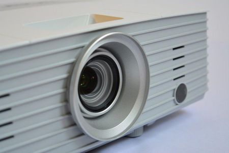

Projector: Really anything will do, but nice bright projectors (800+ lumens) will allow you to start playing a bit earlier. I used an Asus P3B, which has an integrated speaker good enough to handle the sounds and music. This projector is 720P, which was plenty in terms of resolution.

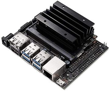

Jetson Nano (x2). This is an embedded development board made by Nvidia. Every hear of the Raspberry Pi? You could actually sub a Pi in for either of these if you have a bunch of Pi's laying around. Alternately, you could run the whole thing off of a laptop, but it's just not as portable. I'm using one Nano to detect the laser, and one to run the game.

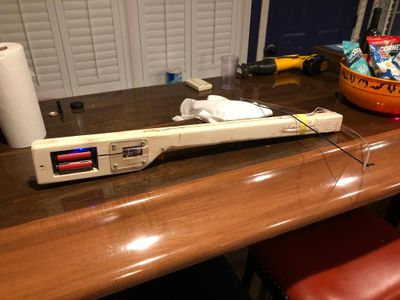

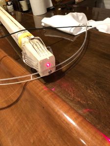

It was 3 days before Halloween, and while I've tested with a laser pointer, I STILL don't have a cool control mechanism to fling forks at zombies. Enter the ForkBow. I started with a 30" long scrap 2x4, and used a band saw to hand cut the general shape. Normally, I measure EVERYTHING twice and do 1/2 hour of calculations before making a cut, so this was good for me. After I had a general shape, I used a belt sander to knock off the corners and splinters. So far I'm in about 5 minutes. From there, I drilled a hole in the front to match the diameter of my laser module, cut a small trench in the top to run power wires to the laser, and drilled a few extra holes to route the wiring. I then hot-glued the laser and wires in place. From there, I designed a few pockets to hold the ESP-32 (more detail on this in a bit) and the batteries. I cut those pockets with my CNC. Please note- I built a CNC last year, and so now I use it for everything. Cutting pockets? CNC. Making a wooden marble run? CNC. Got to sign a bunch of documents? Scan your sig, strap a pen in, and do it with the CNC. The important thing is you don't need a CNC to do this project, you can get by just fine with a hand drill and a wood chisel. In spite of the fact that the whole Forkbow took like an hour to make, it generated more questions on Halloween than anything else: "Did you make that crossbow yourself? How?"
For the trigger well, I just drilled a couple of 3/4" holes with a hand drill, and chiseled the walls flat. The trigger itself is a microswitch, but it has a 3D printed shell over top. Imagine a piece of U-channel with a hole drilled through it, and you've got the idea. The microswitch itself is connected from ground to GPIO0 on the ESP32. Looking to get started on the ESP32? Great! I'd recommend starting over here: https://randomnerdtutorials.com/program-upload-code-esp32-cam/ where Sara and Rui Santos will walk you through basics, then more advanced use of these wonderful boards. You can also find some great instructables!
I covered the ESP32 pocket with a chunk of polycarbonate that I had laying in the shop. The other pocket contained the batteries. Though I didn't need to change them all night, I did leave that pocket open just in case.
For hardware- that was it. Plugged a battery in at the beginning of the evening, and it ran great. Every time you hit the trigger, the ESP32 (connected to the same wifi router as everything else) would generate a UDP packet towards the hit detector. Why the hit detector? To keep traffic at a minimum. The hit detector is always hit detecting, but doesn't report to the game until it sees this UDP packet. I'll provide the source (Python) and a block diagram in the "Integration" step.
