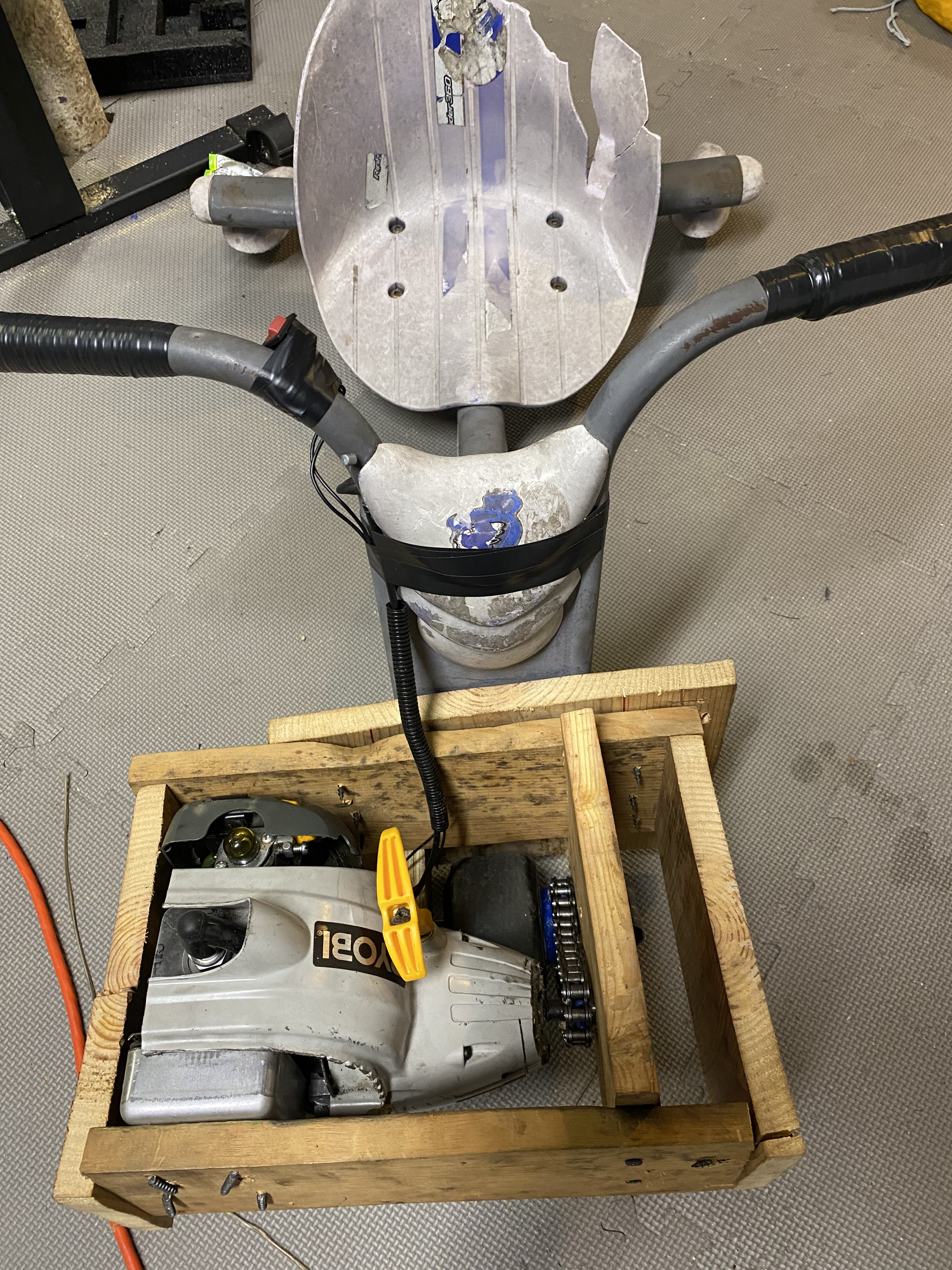

Hi! I'm Ezra Norman from the Chattanooga Christian school. I have invented a one-of-a-kind transmission that uses power from a gasoline engine in a forklift to accurately move the lift. How does it work? The simple answer is that it has two inputs. One from the engine (speed irrelevant torque) and one from a small electric motor (torque irrelevant speed) and the transmission has an output that puts all load on to the engine but matches exactly the direction and speed of the small electric motor. This eliminates heavy and complicated hydraulic systems. I will put how it works in detail at the bottom.

Next up, I 3d printed every piece on my He3d k280 delta printer using super slicer and Klipper. After assembly, it worked! I had designed it to be assembled by melting the plastic with a soldering iron instead of gluing it so that it holds up better. Earlier on, I promised that I would describe how it works in detail so here it is. Let's call the input from the engine A, the input from the motor B, and the output C. For each differential, we have the two side inputs X and Y, as well as the shell Z. output = A->X1, B->Y1, Z1 gear ratio 1:2->X2, B gear ratio 1:-1 -> Y2 Z gear ratio 1:2->C. There we have it. Thanks for reading!!!!
