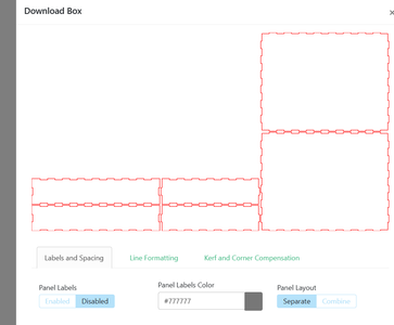

  1. Laser-cut Wooden Box – Custom-designed usingMakerCaseand Adobe Illustratorand cut from:

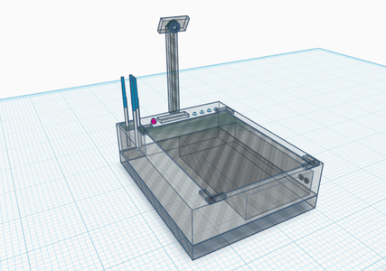

  5. Thinkercad – Used for designing the physical box.
  6. MakerCase: Used to design the faces of the box.
  7. Adobe Illustrator: used to add holes for the buttons, LCD, LED and wires.

Step 5: Design
To finally bring everything together physically, I designed the box for my raspberry pi setup and create a useful, enjoyable place for the user to learn.
I started by designing the layout of my project in Thinkercad, which helped me picture the locations and measurements of all the items I needed. After I settled my design, I created a laser cut layout from MakerCase.
The box itself was built from multiplex wood (4mm), however the top panel was plexiglass(3mm) in order to let light shine on the paper without shadows, so I had to make some custom adjustments. I imported the .svg files generated by MakerCase into Adobe Illustrator, modified the finger joints of the top panel to match the thinner 3mm material, and made my custom paper corners to hold the drawing sheet in place under the camera.
When everything was finished, I made my way to the Industrial Design Center at the Howest Campus. Luckily, the center was open for one night for CTAI students working of this project. I used the laser cutter there to cut the box panels and custom parts.
