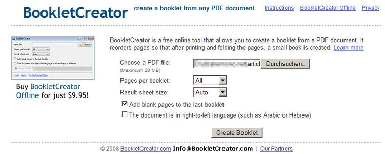

Step 2: Reordering the Pages With Bookletcreator.com
Creating a booklet normally involves reordering the pages. Since a picture usually speaks more than a thousand words, I have MS Paint'ed a sketch of an eight-page booklet for you.
The free Adobe Acrobat Reader actually has an option for booklet printing since Version 8, but printing tends to get complicated and messy if you do not posess a duplex printer. Even if you actually posess a duplex printer, you might want to tend to my method anyway since it gives you more control and options for the booklet creation.
First, go to bookletcreator.com.
Over there, choose the PDF you want to create a booklet of. Leave the option "Pages per booklet" at "All" and make sure that the box that says "Add blank pages to the last booklet is checked". Then click on "Create Booklet".
After a short while, the page will open the reordered PDF. Save the PDF on your computer and continue to the next step.
