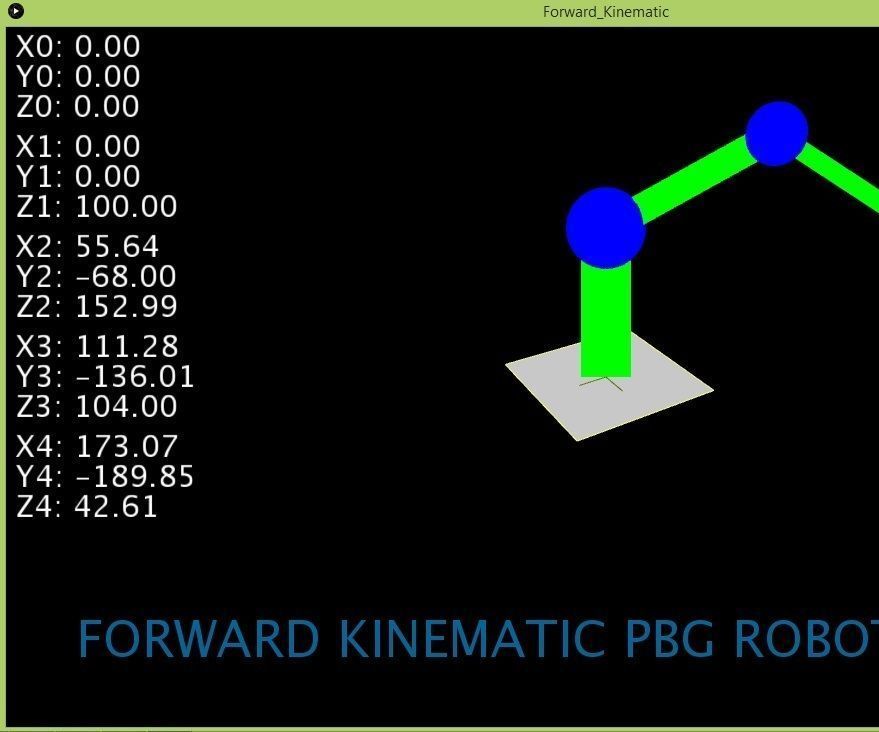

Step 6: Arduino Program Upload
Arduino program files are in the download file.
Step 7: Processing Simulasion
Program on File Downloaded.
