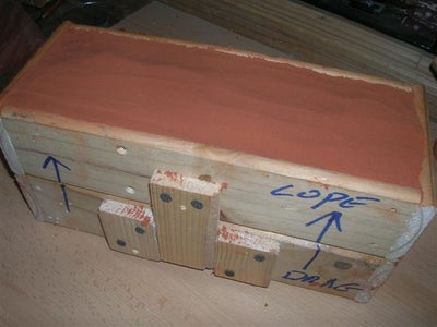

Step 2: The Flask
I made a new wooden flask larger then my old one in order to fit my pattern. The flask is made of 2 parts, top is the Cope and bottom is the Drag. On the side I have wood drilled to keep both parts aligned together. The pattern is placed in the Drag part. The Drag is placed upside down at this stage.
Step 3: Getting the Mold Ready
First I start placing the Petroband over the pattern ramming it with a block of timber and this is where the future ramming tool will come into use. After the drag was coverd all the way up I turned it back up and notched around the pattern half way down smoothing it with a spoon, nail and my trusty finger.
Then a bit of parting powder on top to prevent the drag petrobond sticking to the cope.
