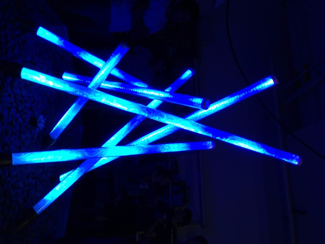

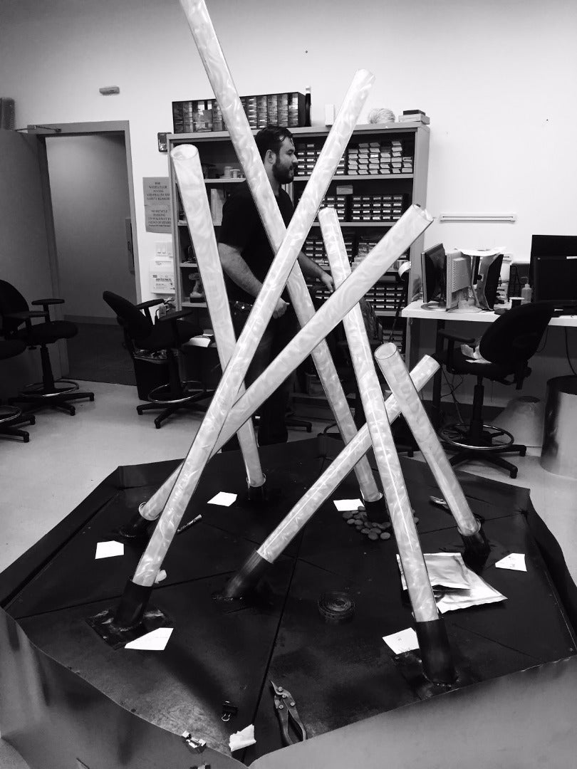

For the design of the tubes, we wanted to emulate the crashing of waves on a rock in the middle of the ocean, so we arranged the tubes in an abstract manner with all the tubes pointing inward at different angles and cut to different lengths, so it looked like water splashing up into the air.

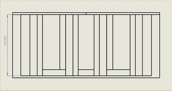

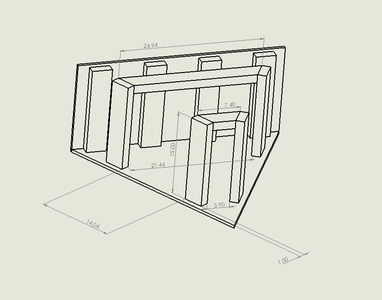

For the bottom of the structure, we made a compartmentalized base composed of 6 triangles to make the base more mobile.
Using the dimensions in the first four photos above, we cut all the pieces of wood to size and drilled them together using household screws. We also designated the top of each triangle piece as the side with the extra 2x4 support since the top would hold most of the weight of the tubes.
Once all 6 triangles were created, we arranged them together in a hexagon, so that there was a solid outside for the base but the inside was open to allow for wires and power supplies to be hidden inside.

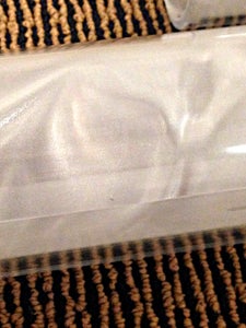

After trying the lights through various materials, we decided the light was best diffused and looked most fluid when it was in the acrylic tube and surrounded by the Illusion film.
However, it was difficult to get the illusion film to perfectly cover the inside of the tube without overlap or gaps, so we cut the pieces of illusion film so that there was about an 1/8" overlap. Then we rolled each piece up and put it into its respective tube, taking care not to twist the film.
To attach each tube to the wood base, we first made base plates of 7" x 7" cut out of the steel sheet and then drilled a hole of 1" diameter in the middle of the base plate for the wires to pass through and drilled four smaller holes in the four corners, each large enough for a standard packaging screw. Then, we cut the steel tubing into smaller tubes at the desired angle (see above) and long enough so that the shortest side of each tube was 4". Then, we soldered the tubes to the base plates so that the tube is aligned with the large hole.
Before we put the tubes into the steel holders though, we lined the inside of the steel tubes with packaging foam to prevent the steel from scratching the tubes and to create a more secure fit.

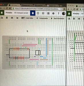

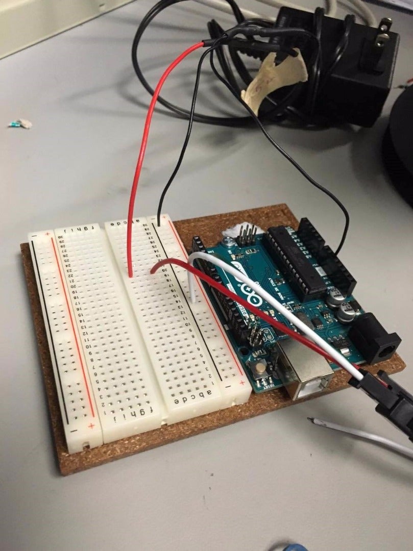

Begin the process using a breadboard to test all your connections before you make them permanent. (Warning: when using power supplies, don't run much current through the breadboard itself. We used a hacked low current power supply to test our LED strips individually with the breadboard and the code before we finalized our project - see first picture). When you decide to finalize your board, solder everything to a protoboard.

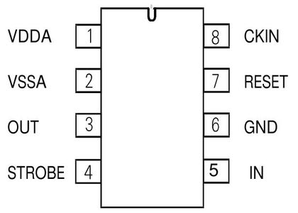

If you want the music equalizer, you'll need the MSGEQ7 chip as well (pinout picture included) and a slightly more complicated circuit board, also shown two ways in pictures included above.
