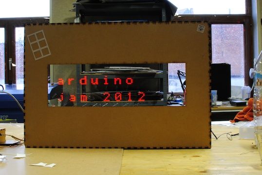

Currently one short movie to give a quick impression of the project. The basic concept is to build the four-on-a-row game. We did this by building a 2color 2D martrix using red and green SMD LEDs. The matrix is driven directly by an Arduino Mega without any addtional driver ICs. WIll update with a step by step explanation when the jam is over
