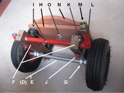

Step 2: The Front Unit
Taken the axle D with the wheels from the handcart. Remove one wheel from the axle to take the brackets off the axle. Put a piece of 22 mm central heating pipe E over the axis to keep the wheels in place. Make sure the wheels are tight on the axle, not wobbly, to prevent excess wear and tear. Use washers to fill up the space.
Two suspension bearers of wood F are resting on both sides of the axle, fastened by brackets G. In order to obtain independent suspension, the main board H is resting on 4 bike seat springs I, which rest on the suspension bearers.
4 bolts J stick down from the main board trough each spring and trough wide holes in the suspension bearers, to guide the springs and keep them in place. A washer and locknut at the end prevents each bolt from coming loose. A hole at the front K in both suspension bearers is made for the tilting part of the boom L, which will connect to the rest with 2 compression elbows M.
The rotating board N will be rigidly attached to the back assembly and will rotate on the main board. It rests on 4 teflon furniture gliders P and rotates on a bolt O and locknut in the centre, with washers in between to keep spacing.
4 bolts sticking out on top of the rotating board are to receive the connecting beams from the back assembly.

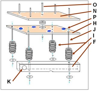

Step 3: Drawing of Front Unit
Hopefully this drawing makes the instruction easier to follow:
O: Rotating bolt, washers for spacing
N: Rotating board, with 4 bolts sticking up for connection to back unit
P: Teflon furniture glider
H: Main board, with:
J: 4 bolts sticking down, to contain springs. Locknuts and washers at the ends
I: Springs from bike seat
F: Suspension bearer, only one is drawn. Rests on axle in middle, not drawn
K: Hole for horizontal part of hitch - 22.5 mm

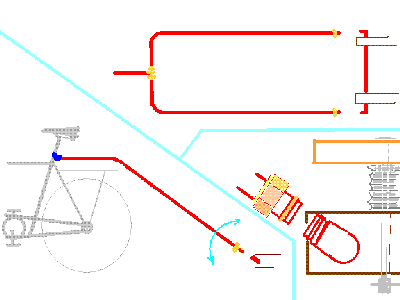

Step 4: The Hitch
Made from central heating steel pipe. One part, with compression elbows, is part of the front unit. The big part is to connect to the bike. It can be connected to the fittings of the part on the front unit.
The hitch has proved to be too long, amplifying vibrations.
The new hitch can be connected by the same compression fittings. Compression fittings are a very good way of making a strong, but removable connection.
Step 5: Receiver
I already had the receiver from another, very light trailer.
It allows pivoting up and down, allows turning and allows some left and right tilting.
The updated receiver (for the new hitch), is located near the left side of the rear axle of the bike
