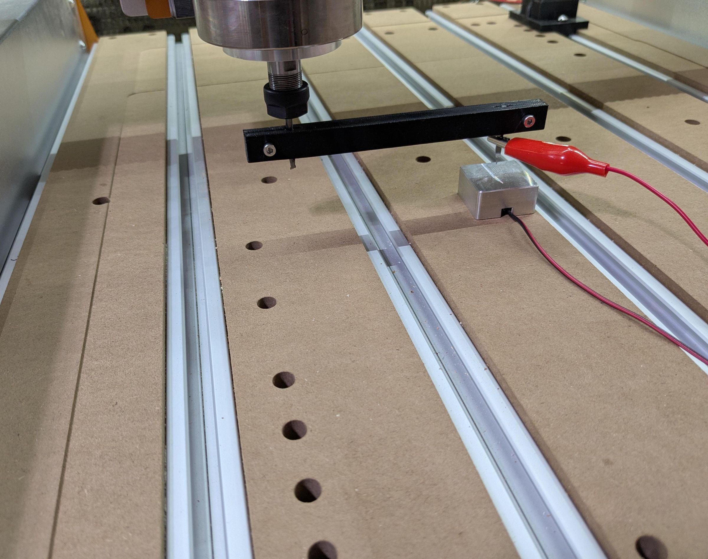

I added an extra wire to connect the AC ground to the DC ground. This permanently connects the spindle to the CNC ground, which means you don’t need the alligator clip when running a Z probe. This is represented by a dashed line in the schematic.

4. Connecting the AC ground and the DC ground is optional. I don’t see it discussed frequently for this class of machines, probably because it doesn’t work for stock DC spindles and palm routers. It is incredibly useful, however, as it removes one step from the probing sequence. If you use the paper method instead of a probe, then this is something you can safely skip.
