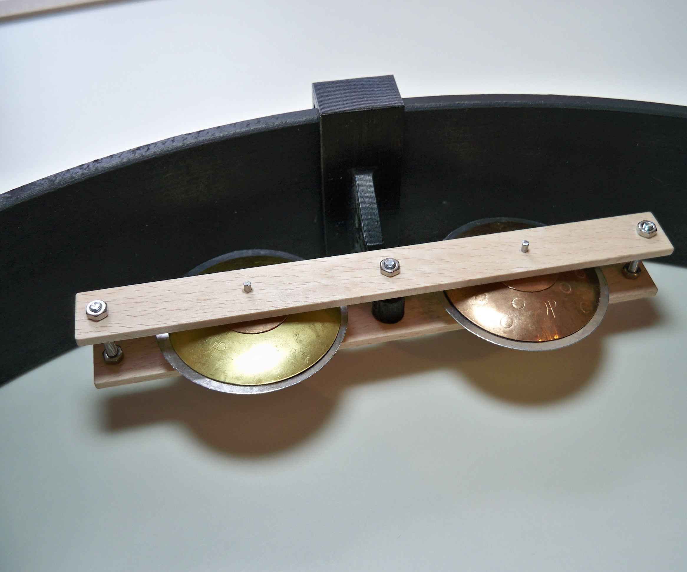

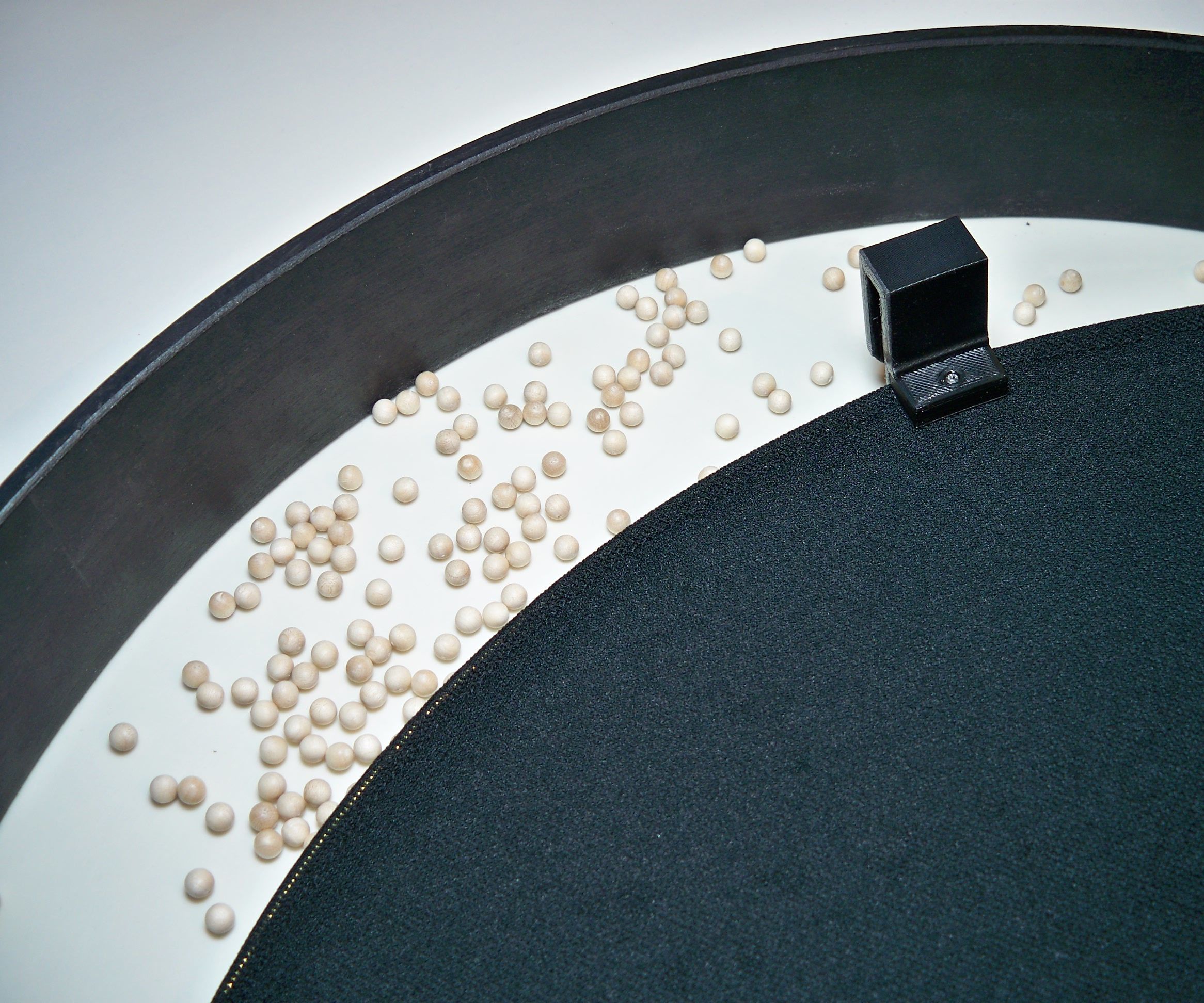

We are now ready for the assembly. As shown in the images above, insert the nylon cord in the left hole of the top clamp first. Since my cord is a 0.4mm cord, I used a bead as a stopper before placing the knot on the cord.
Now run the cord from the top clamp to the left hole of the bottom clamp. Change the direction and run the cord through the middle hole of the bottom clamp back to the middle hole of the top clamp. Again change direction and run the cord from the right hole of the top clamp back to the right hole of the bottom clamp.
Next mount the clamps on the drum. Make sure that you put the clamps on the drum in such as way that they are directly opposite of each other and that the cords do run through the centre of the dream head, i.e. the cords should meet the clamps in a 90 degree angle.
Tension the cord with your fingers and make a first sound check. You can make the buzzing sound more prominent by putting some beads on the cord.
Happy now? Take a pen and mark the spot where the cord leaves the slider. Unmount the bottom clamp, put a bead on the cord as a stopper and put a knot exactly on the marked sport. Now remount the clamp and tension the snares with a screw driver / hex key. If you have put beads on the snares: Use some tape as stoppers to prevent the beads from travelling all over the snares when playing.
