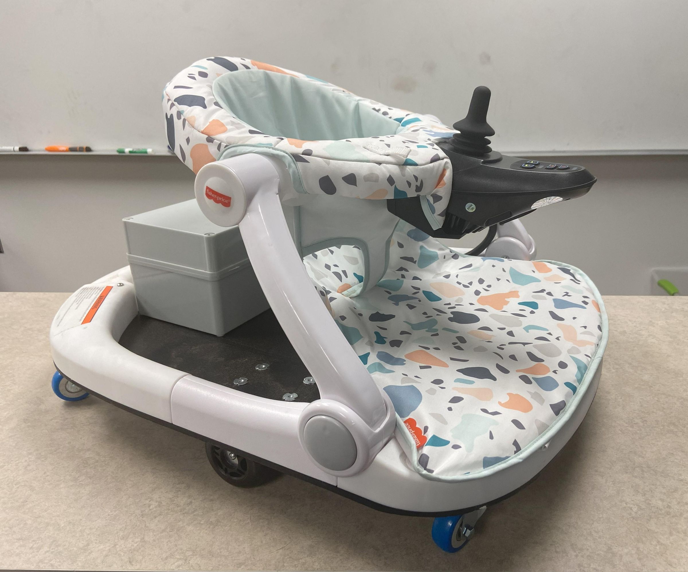

This device it used by individuals with limited balance, by sitting on the seat the user can propel the device with a running motion. The three wheels and wide stance keep the device balanced allowing the user to reach great speeds.

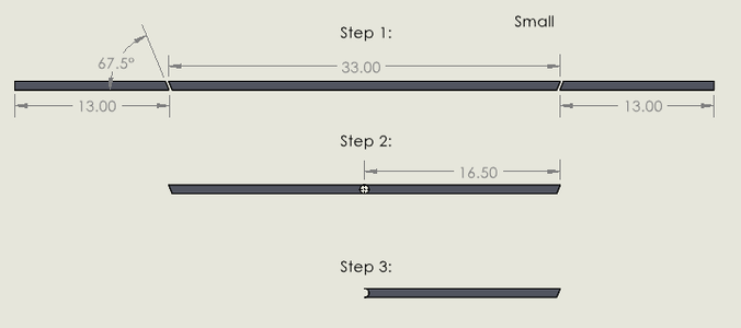

Step 2: External Frame
Cut the 3/4" square tubing to the required lengths. When drilling the holes for the rear axel it is easiest to cut the square tubing longer than necessary, drill the holes at the desired length, then cut the remaining square tubing in the middle of the hole that was drilled. In the half circle left by the hole weld the axel shaft in place.

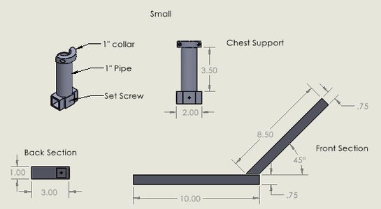

Step 4: Center Post

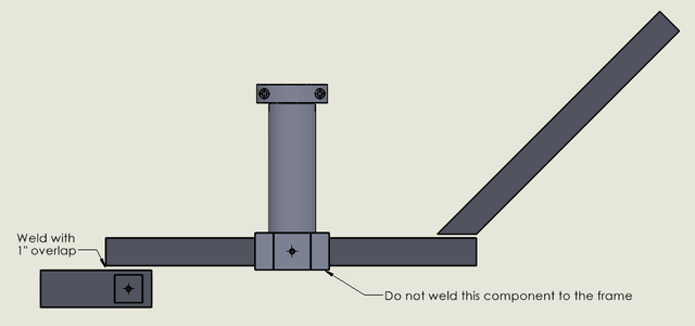

The center post needs to be assembles in stages to allow the chest support to be adjustable. Weld the front and back sections separately. Before welding the front and back together slide the chest support onto the front section of the center post. The chest support should be able to slid forwards and backwards to allow for adjustability.
When welding the center post to the frame have the rear wheels on the frame. This will help ensure the horizontal section of the center post is level. The wheels are attached with quick release axel pins.

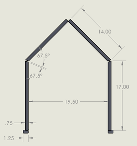

Step 9: Small Frame Plans
When building the small frame runner use the above dimensions.
Wheel diameter 12"
