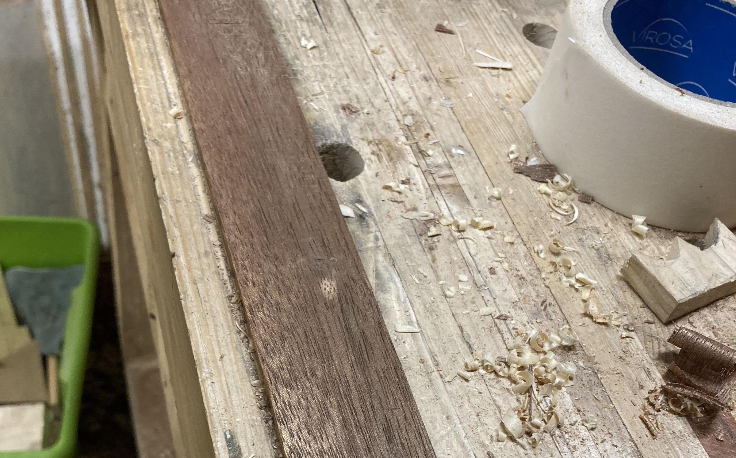

So having got the bits to length, it time to cut the holes and joints. To make sure the holes lined up, I taped the two pieces that would make either end and then marked them up together. In the same way, while these two pieces were taped together, I drilled the hole for the blade holders through both pieces at the same time.
