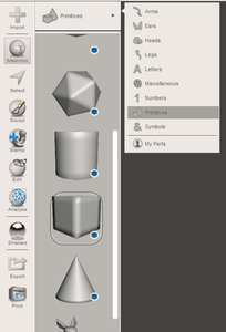

  5. We need to add the base plate to the model.
  6. Select Cuboid from Meshmix - Refer to Photo 4
  7. Scale it according to your needs. For using my scale refer to photo 5

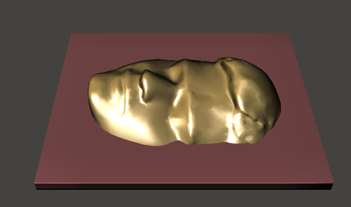

  8. Now we need to combine these two bodies. First, you need to align the face model and base plate on top of each other using the transform command on the face model. Refer to Photo 6.
  9. After Finishing the alignment, Select both item's whole pressing shift. Then use the command Combine.
  10. Your Face Model is ready :)
  11. Export the face model into stl format.

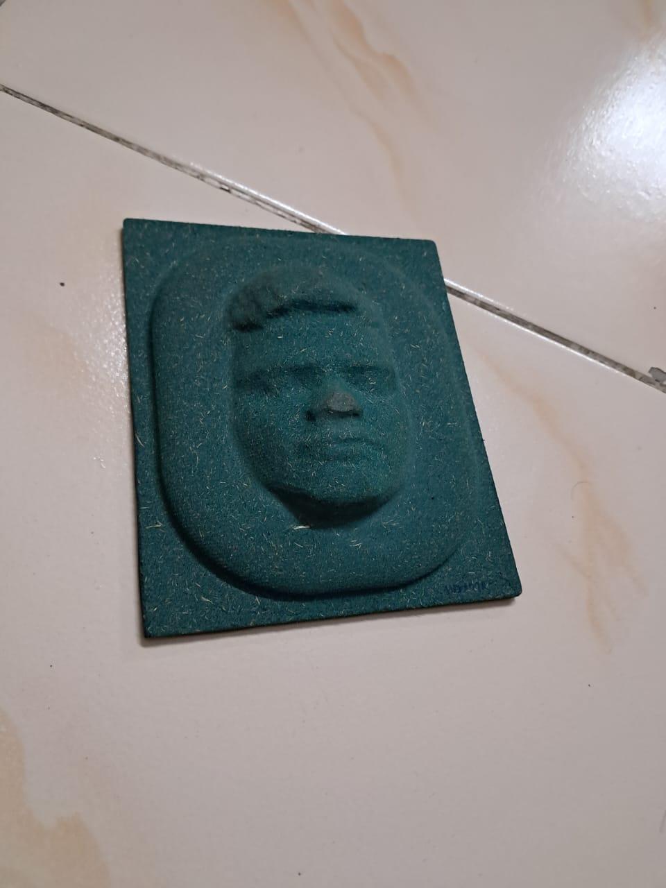

I chose Machining (CNC Router) because I had access to it. I will cover the steps I have taken.
For 3D printing you will have to slice up the model in a slicer and import the model in 3d printer
Step 5: CNC Router - Machining
CAM is a software which gives path for the machine cutting tool.

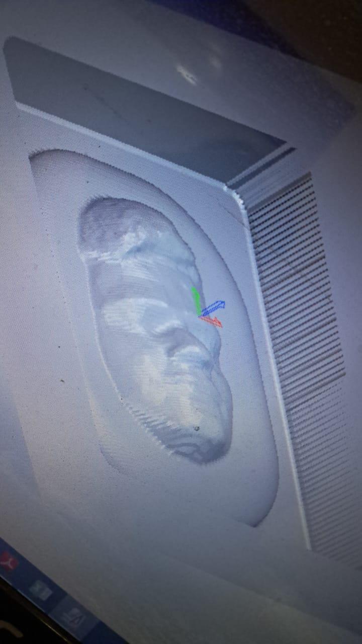

For machining you will have to import the model in a CAM software. There are various options for the software. The industry I sent used ArtCam for CAM. The Cam setting was done by the designer in the industry. It was designed for CNC Router Machining. I have attached simulated photo and machining process vedio.
Some Specification for machining were -
  1. Material Selection - HDHMR
  2. Machine Selection - CNC Router
  3. Tool Selection - 4 mm Ball nose
  4. Step Down- 4mm, Step over - 0.5mm
  5. 10000 rpm spindle speed
  6. Machining time = 2 hr
  7. Machining cost = Rs 700
  8. 120 x 140 x 25 mm Material cost = Rs 55 (Rs 300 / sq feet )
These are some of the specifications. If you wish to make the 3d photo in metal, you can perform the machining on VMC (Vertical Milling Machine).

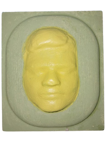

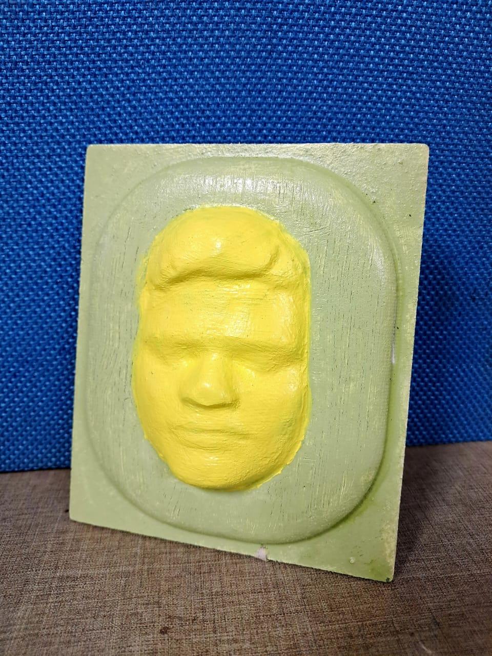

Step 6: Finishing
With this done your technical stuff comes to an end. Your 3D face model is now complete!
Follow the following steps -
  1. Polish the Face Modelwith Fine Polish Paper. Dust it off with a soft brush.
  2. Apply Glue and Water in 50 - 50 proportion and apply the mixture to the model. Apply 2 or more coats of it. You can also apply MDF primer.
  3. Let it dry.
  4. Unleash your Creativity!
You have many options you can decorate and paint the model face.
Step 7: Painting
I only Painted it with Acrylic color.
