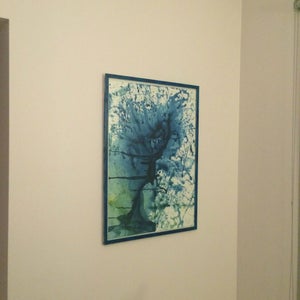

My version of making custom sized frame for painting on thin paper that needs to be pressed between glass and back-plate. Construction is made strong enough for very heavy 6mm organic glass.

Step 4: Put It Together
Before putting it together you can apply some varnish or painting coating (I painted it). Do not paint it when it is attached to picture.
Next use tiny screws to hold back plate in place.
