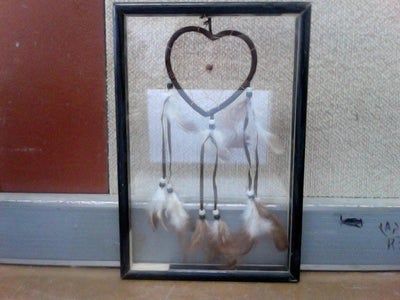

Quite often I come across old timber that would be great for a project but there just isn't enough of it to make a piece of furniture or a substantial project.

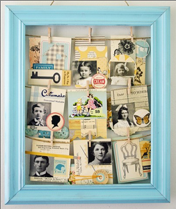

By making a picture frame I can use this small amount of timber that would normally just be thrown out or burnt. You can also get creative with what you put in the frame it doesn't just have to be a picture, license plates, coins, tee shirts, coat hooks, cards stamps or collections of flat objects. I particularly like the clothes line photo frame idea.
Depending on the look I'm after I will either sand the timber thoroughly or as in the case of the plate frame leave the paint on to give it an aged appearance

The sanding is easier to do if you do most of it before you cut the timber, and depending on the look your after, you can give it a light sand, just enough to make the paint look worn and aged, or you can sand the hell out of it with a machine and make the timber look almost new, or somewhere in between. The photos have examples of each. I like to use furniture oil to protect the timber as I like the matte natural looking finish, and it smells better than polyurethane or paint. The furniture oil will also make old paint look fresher as it makes the colors stand out and gets rid of that white powder layer of oxidized paint.

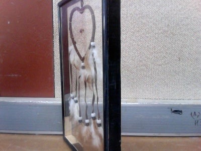

You have a few chooses about how you attach the back board. If your not planing on removing your image from the frame, the back can be stapled on, but care needs to be taken if you have glass in the frame. Masking tape also works well for small frame. If you think you would like to replace your photo regularly then some small strips of MDF can be cut and screwed or nailed into the frame so the back can be removed.
All that remains it to staple a piece of string to the back of the frame and hang it up.
The photos are of some of the frames made with recycled timber.
