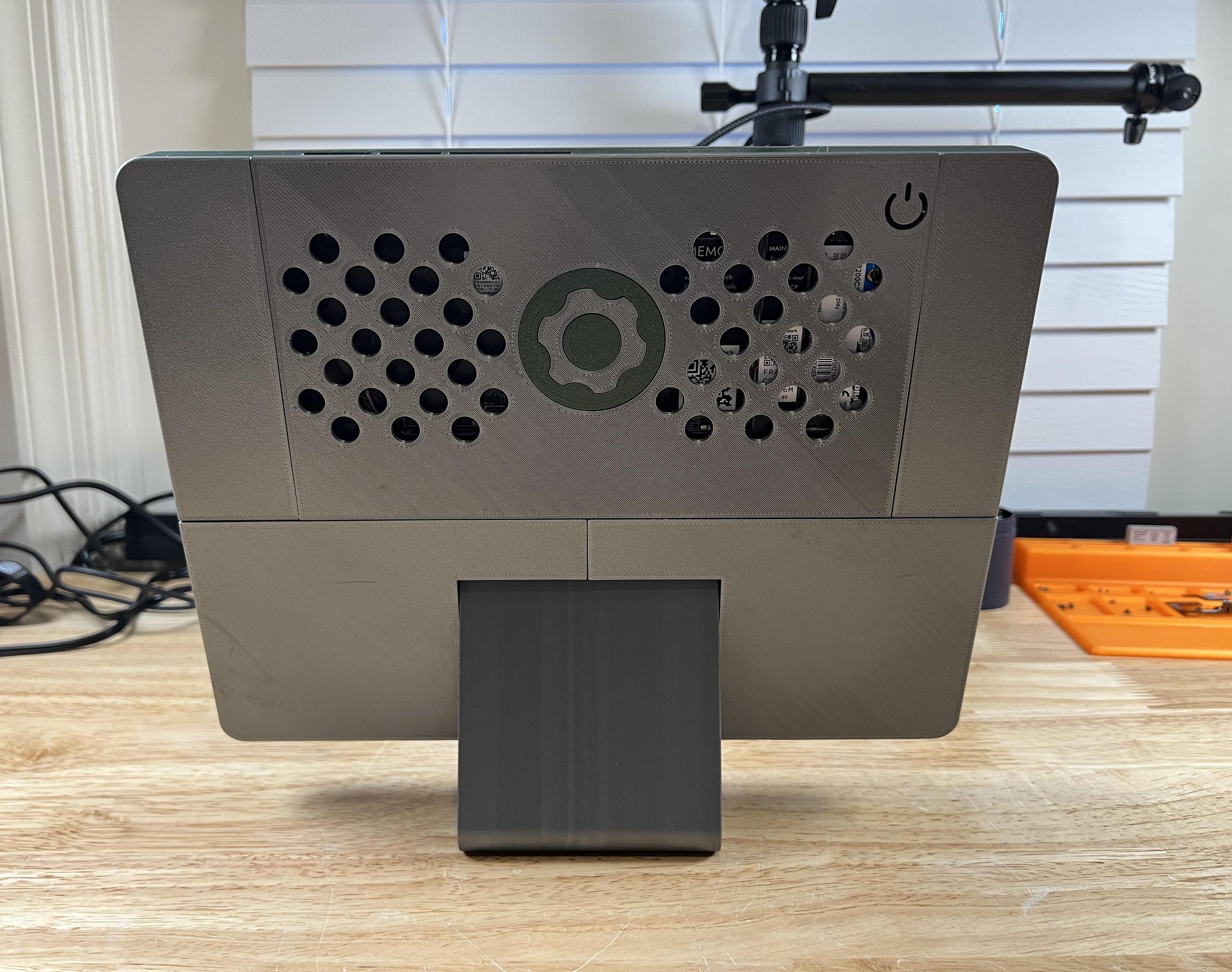

This assembly guide is intended to walk through how to assemble the 3D Printable Tablet Case for Framework Laptop.
The ethos for this project being is to make as few changes as possible to convert a Framework Laptop to a tablet form factor. In this case, I've used as many OEM Framework parts as possible.
The whole thing is held together with M3 fasteners and heat set inserts.

Congratulations! You now have a functional Framework Tablet!
I hope you enjoyed this build. Be sure to let me know if you have any recommendations for improvements to the build.
