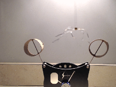

Franklin had an assortment of electrostatic generators. For projects like this, which relate to historical apparatus, my favorite is a miniature Wimshurst generator. Those shown in the photos are the SparKIT. But you could use an electric fly swatter, or a negative ion generator, or even clothes straight out of the dryer – anything strong enough to produce a spark. (Note: I'm not affiliated with the makers of the SparKIT or the YouTube video linked for the fly swatter - but I appreciate what they've done and encourage you to check them out.)

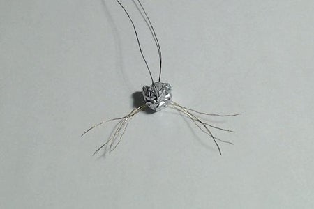

As noted above, you want the spider's legs to be able to "flop around." If you use standard thread from a spool, that requires the "legs" to be a few inches long. Thicker cotton floss (being heavier) and the more flexible tinsel usually works well as long as each leg is over an inch (~2.5 cm) long.
Rather than making eight separate legs, it's easier to use four pieces of thread or tinsel, and pass it through the body - leaving half on each side. It's easiest to start with some extra length that you can trim down, so get four pieces at least 8 inches or so (about 20 cm) long.

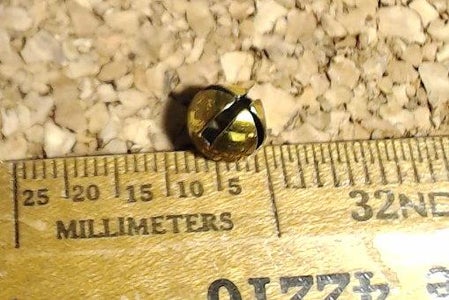

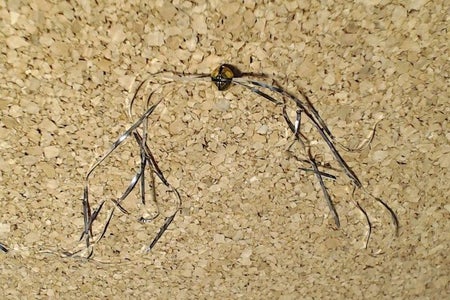

My favorite version did not require much work at all: I simply used a small (~8 mm) craft bell. Other successful versions used ~1 cm ball of loosely-crumpled aluminum foil, or a ~1 cm piece of a Styrofoam packing peanut painted with high-carbon ink to make it conducting.

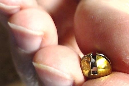

For the bell, I used a knife to expand its slots, so I could fit the tinsel inside.
Step 3: Finish the Spider
I slid the tinsel into the slots in the bell, crimped the bell shut, then used some cyanoacrylate (super) glue to keep the tinsel from sliding. On other tests, I used a needle to thread the threads/floss through the body.
Once the conducting parts are complete, suspend the spider from at least 12 inches (30 cm) of insulating thread. You could thread through the body or use glue - you have a lot of options, and it should be easy to accomplish.
Step 4: Turn on Your Generator, and Enjoy
To get the spider to dance, you need to have either two oppositely-charged objects at around the same height, or one charged object and one "grounded" object. In most situations, your body can serve as a good ground.
If you have the SparKIT, the two rods sticking up are guaranteed to have opposite charges, so it's easy to work with. If you use an electric fly swatter, you'll need to pass insulating wires to the two grids (carefully, as shown in the linked video) and position them in a way the spider can reach.

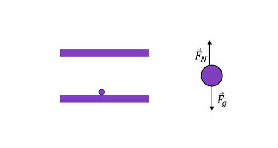

The principle is the same as in many other demonstrations, such as Franklin’s Bells, or a Volta’s Hailstorm: opposite sign charges attract, like charges repel. Effectively, it’s the same explanation as shown on my “Make a Volta’s Hailstorm” page, turned on its side.

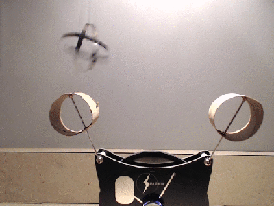

Step 6: Franklin's Bells
Of course, if spiders aren't your thing, you could use almost the same materials and steps to make a nice Franklin's Bells demonstration.
