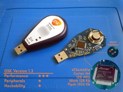

First you should disassemble your logger and check out the model of MCU. Two out of four boards I examined had STM32L152 low-power MCU, one had Atsam4S16b MCU and one had Atsam4S4b MCU. Atsams are more powerful, but official debuggers are expensive, so I shelved those boards for further experiments.
If you know about some affordable way of programming Atsam MCUs, please share your ideas in the comments.
If you are lucky enough and have a board with STM32 MCU, it might be possible to use a cheap ST-Link dongle to program it. It’s what I’m going to do.
On some boards you might find other usable items, like flash and EEPROM memory chips. Please check out the attached pictures.

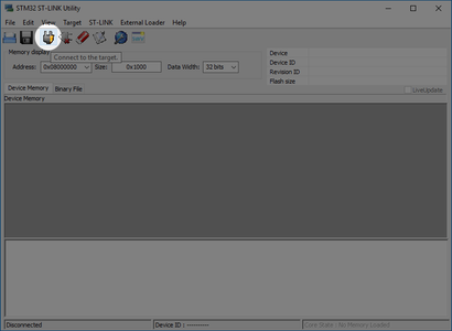

Connect 3.3V, GND, SWDIO and SWDCLK pins to your programmer. For the first connection test I suggest that you use an official ST-LINK utility. Connect your programmer to USB port and press “Connect to the target” button. If everything is ok, you should be able to see data from your microcontroller.
