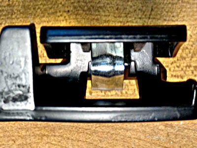

Now look carefully at the clip examine the layout of the hinge. Remember, with so many styles out there, you want to make sure that when you start the incision, you won’t be cutting into any of the clip’s vital organs (of which they have only one, the hinge).
Step 3: Make the Cut
Using your favorite cutting tool, carefully cut along the imaginary dotted line spares the hinge while separating it from the hanger. Take your time, but don’t dawdle – no reason to cause the hanger more pain than is necessary. The hanger plastic is relatively soft and I found that I can amputate a clip in about 6 seconds. Basically before the hanger has any idea what’s happening.

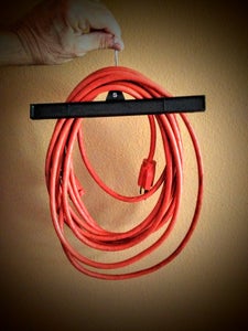

If you act right now, you get not only two clippies from each hanger, but you get a new chord hanger absolutely FREE! That’s right two clippies AND a Chord Hanger for the price of the clippies alone won’t last long, so call now – operators are standing by.
