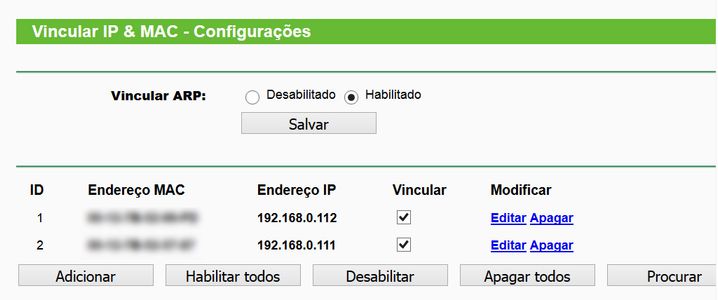

Step 5: Router and Foscam Cameras Setup
On Tp-link Router Config Page:
It helps to avoid conflicts binding Mac-Address and Lan ip, the router will only provide fixed lan ips for that mac-address. See image.
Virtual servers - add your cameras Lan Ips and corresponding ports.
Leave DHCP server enabled on the router.
Check enable Upnp on the router
You can also config Remote Management of your router, in Tp-Link router it is under Firewall item.
You will be able to open router configuration page remotely. Beware to change default login, because it will be available openly. Fill in 255.255.255.255 and a port tipically 8080.
