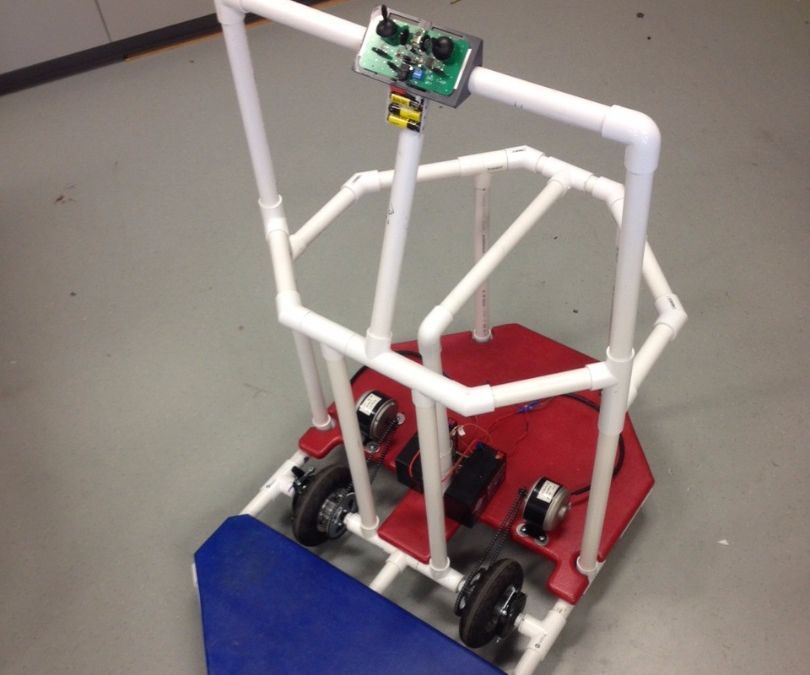

Step 1: The PVC Remote
Using PVC as a prototyping material was generally pretty quick. The picture represents a slight variation to the first remote I drew on paper and the center XBee square on the bottom worked better than the top. I didn't want to make it too heavy but I wanted it to be solid. Cut out the necessary pieces below and stick it all together according to these dimensions.
1 Long Piece (top) 7 3/4"
2 Sides 4"
2 Bottom 2"
4 Square 1 3/4"
The breadboard that will be assembled in the next step will need a place on the PVC remote. After much thought on the many different ways to accomplish this I used 0.093" thick acrylic sheet from Home Depot. Although I have inserted the acrylic inside the PVC I am not sure if it was necessary. Simply gluing it to the PVC may suffice and safe you the hassle (I used a chop saw and a drummel but you have to be comfortable with power tools). I used Loctite Stik N Seal which dries transparent and has no odor. From the picture I also mounted a piece of acrylic on the bottom of the square so that the battery and wires would not float through the bottom.
2 Sides 4"
2 Bottom 2"
4 Square 1 3/4"

Step 5: Test Run and Extension Considerations
So, inevitably there are details that I should have included but failed to so feel free to make a comment and I will fill in some blanks. My hope is to take this system and make it work with multiple users like in FTC and FRC competitions. I think the XBee is versatile and capable enough to handle 2 or even 3 students controlling one single robot as a team. Adding extra analog or digital lines should also not be a problem to increase the functionality of any single remote. A servo or extra motor would be a good place to start.
I hope someone reads this and comes up with something really great. Let me know if you do. Have a great time building.
