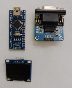

Step 1: Components
  1. Arduino NANO board
  2. Microchip/AVR Studio program to build and flush the project source code
  3. OLED display SDD1306 or SH1106
  4. TTL Serial Port Converter Module DB9 Connector For Arduino
  5. Web Browser to access OLED Editor App
  6. DB9 RS232 cable to connect Arduino serial port to PC serial port

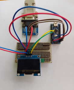

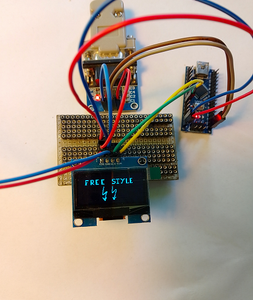

Step 2: Connect SSD1306 or SH1106 OLED Display to Arduino NANO
  1. Connect wires SDA(Yellow wire), and SCL(Green wire) from I2C OLED Display to A4(PC4) and A5(PC5) Arduino ports
  2. Connect wires TxD(Gray wire) and RxD(Brown wire) from DB9 TTL Serial Adaptor to D0(PD1) and D1(PD1) Arduino ports
  3. Connect Serial Adaptor cable to PC Com Port

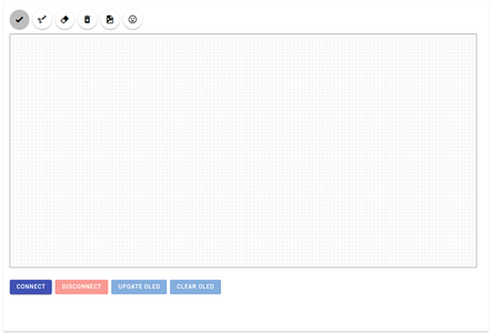

Step 4: Web Browser Editor App
Navigate to OLED Editor App and click Connect button to connect to Arduino NANO. Default baud rate is 57600 , Data Size: 8-bit ; Parity: None ; Stop Bits: 1 ; Flow Control: Off.
Description of header buttons
  1. Escape or Cancel - resets drawing operation
  2. Draw - free style bixel by pixel drawing
  3. Eraser - remove pixes from canvas
  4. Clear Canvas
  5. Load Image - load and display on canvas png image. Image must be 128x64 to fit the screen and will be converted to 1 bit per pixel image.
  6. Load Icon - load from predefined embedded in app icons
Description of Bottom buttons
  1. Connect - open Serial RS232 communication channel
  2. Disconnect
  3. Update OLED - send all canvas pixel or image changes to OLED display screen.
  4. Clear OLED

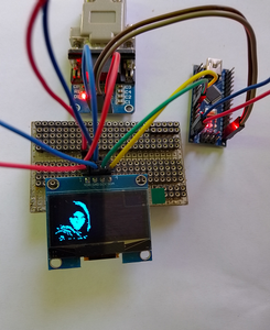

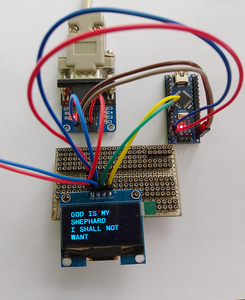

Step 5: Display Free Hand Drawing

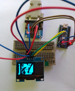

Step 6: Display Image

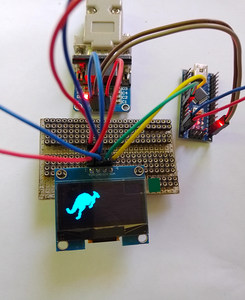

Step 7: Display Icon
