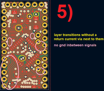

1) Every signal that crosses another signal should have a return current via on all sides. If several signals cross each other, the layout should look like in the screenshot.
2) If just 2 signals cross each other, then place the vias as shown in picture 2 of step 8.
When you look at picture 3, you will see that randomly via stitching a PCB is not really helpful, even though many layout engineers do that. Please keep in mind that layout engineers often are not too experienced regarding EMC - even after decades of work experience - as they typically dont spend time in EMC chamers to troubleshoot problems, they follow layout design guidelines which often come with "strings attached" and might help with one problem but generate problems in other areas.
4) If you dont really know what you are doing (yet), changing from a 2 layer PCB to a 4 layer PCB is a good start as it improves emissions without you having to think about it.
The big advantage of a 4 layer board is that it reduces the distance from GND to the signals on each layer from typically 1.6mm to just 0.2mm which is 8 times less. This increases the capacitive coupling between the traces and GND which reduces the capacitive coupling effects to "the rest of the world" and hence reduces emissions.
Another major advantage advantage is that you automatically eliminate all ground plane interruptions beneath the traces by having a continuous ground plane below all of them.
However, keep in mind that even a 4 layer board with full ground planes on L2 and L3 does not automatically ensure that ground is next to each trace. It also does not address the issue of missing return current vias during layer transitions (see picture 5)
