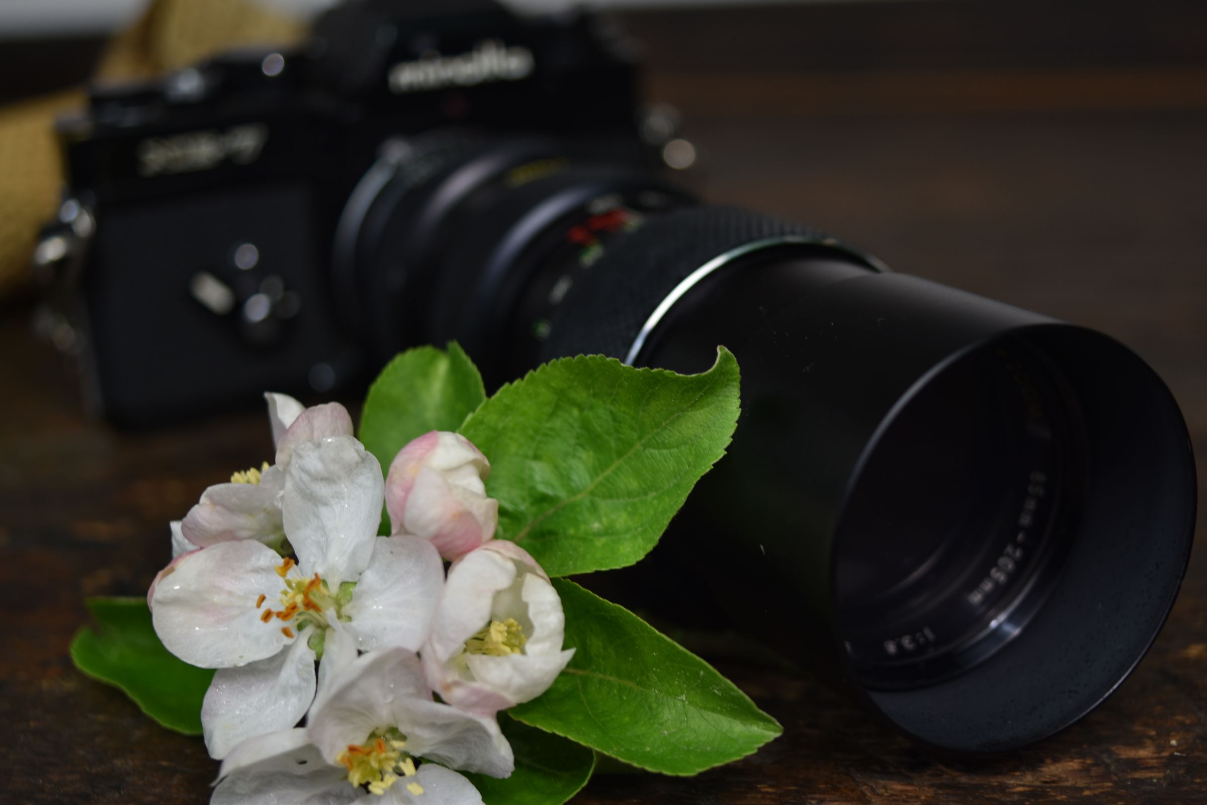

Step 3: Tilt-Shift Photoraphy
By tilting and shifting your lens you get some interessting effects. In the pictures you can see that the camera or flower is sharp in the foreground and the camera body is sharp in the background but the middle is out of focus. This effect is only possible with tilt- shift lenses, lens babies (pretty expensive) or Free Lensing. When you are taking photos as usual you can get either the fore- or the background or both (small aperture) in focus.
An other effect I've read about is that you can get is a miniature effect by tilting your lens, but I havent't tried it yet. Something I will definitely try in the future :)
Step 4: Macro
If you put your lens further away from the camera body and then get the object with the distance between body and camera in focus, you will get a macro like effect.
