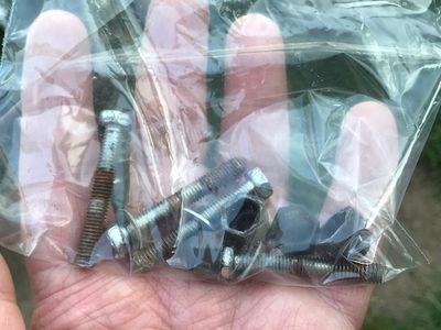

I began by removing the caps from the bolt heads. These were plastic and came off easily. Then I removed the four bolts attaching the seat rails to the frame. I placed all of the small parts of the chair in one zip-lock plastic bag. Having just moved, everything is in chaos. That and I tend to lose things. I set aside the base. Note that the "free" sign is still attached. I removed the caps from the ends of the seat rails. Care had to be taken to avoid damaging them. For some reason they were especially fragile. I removed the tension rod from between the seat rails. Then I used pliers to pull the seat fabric and the cleat rods from the rails. I intended to use the cleat rods to hold the new fabric seat in the frames. This turned out to be a wise decision. I don't make those often, so take note. Care was taken to avoid damage. Once the chair was disassembled, the project had two distinct work paths: The Frame and The Seat.
