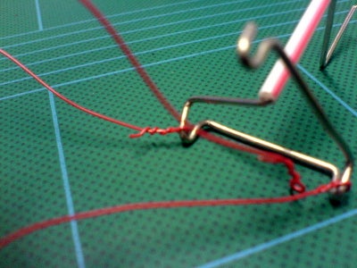

I needed to neatly twist some small gauge electrical wire for a project to neaten the wiring. As I was sitting around waiting on some other stuff, I decided to make a wire twisting jig out of a paperclip and a coffee stirrer - two items that should be "free" to anyone who works in an office. The only tools needed are a small pair of pliers, knife or scissors, and some tape (and the wire, of course). I just used my trusty Swiss Army Knife.
It worked great!
I made two versions, one for twisting two wires and one for twisting three wires. The three wire one is documented here.
It worked great!

Step 4: Form a Triangle
In order for the wires to twist evenly, they must rotate around the center at approximately the same rate and distance, so now you need to form an equilateral triangle with a hook at each corner.
When you get them approximately equal, bend the last end so that it crosses the midpoint of the opposite side, forming something that looks like a 4.

Take three equal lengths of wire and twist or tie the ends of each wire to one of the hooks on the twisting jig.
Take the free ends and tape them to the table tightly (keep them spread apart a bit).
Now, hold the jig by the stirrer, pull the wires slightly taut, and crank the handle with your other hand. Continue to twist until the desired tightness is reached. Be careful not to twist so tight that the wires break. When you are done and release the crank, it will unwind a turn or two due to tension, but the twisted wires will stay together.
Cut the wires from the hooks and slide the remaining loops off the hooks and discard. Carefully pull up the tape and dress the ends of the wires to the length you desire, strip them, etc.
