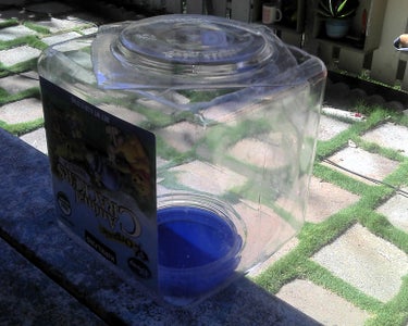

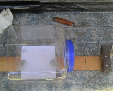

Step 1: Remove Bottom
1 - Cut out bottom of animal cracker container.

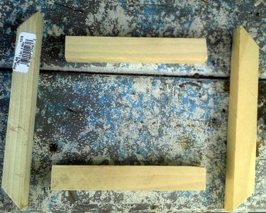

Step 2: Frame Pieces
2 - Cut frame sides, my inside dimension was 6 5/8" square, I cut off corners so it would sit lower in the container.

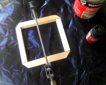

Step 3: Assemble Frame
3 - Assemble frame, gluing seemed easier than nails or screws.

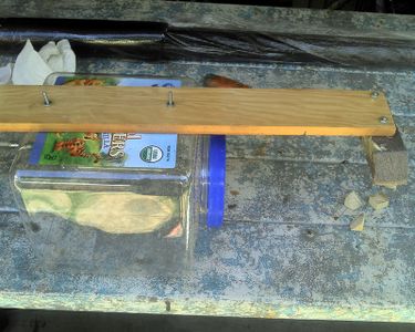

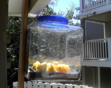

Step 4: Stand
4 - Attach container to stand. Bottom of container should be elevated to allow free entry of dry air.

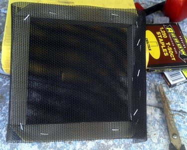

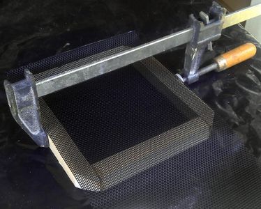

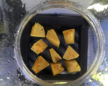

Step 5: Attach Screen
5 - Staple screen to frame. I placed some staples across frame joints to add mechanical hold to glue joints. Screen wraps all away around so top screen supports product and bottom screen keeps insects away.

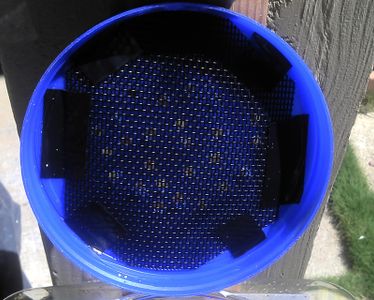

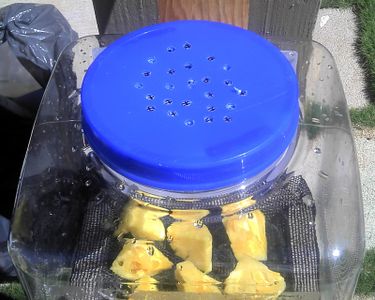

Step 6: Modify Cover
6 - Ventilate cover with holes and screen.
Step 7: Place Frame in Container
7 - Place screened frame in container.
Step 8: Dehydrate
8 - Place food in screen.
9 - Place dehydrator in sun.
