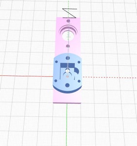

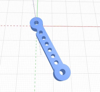

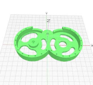

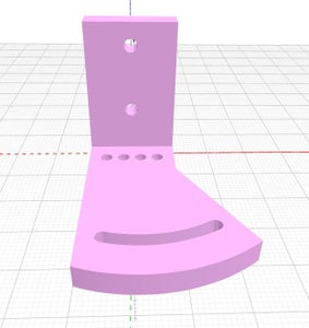

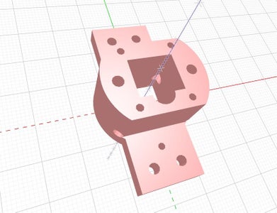

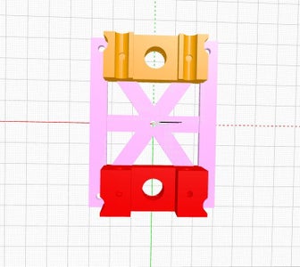

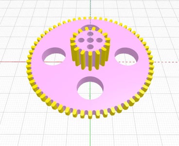

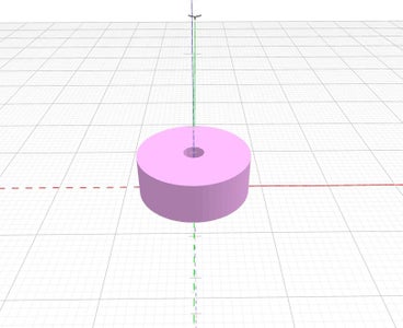

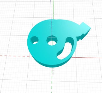

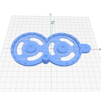

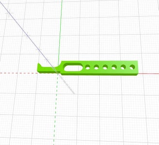

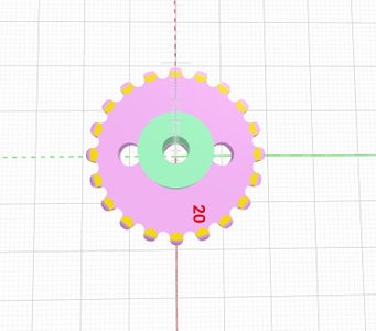

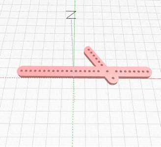

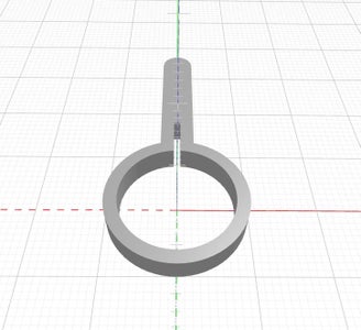

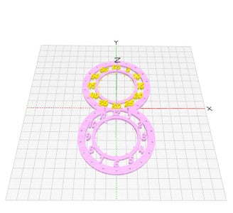

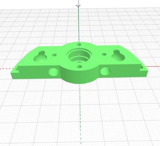

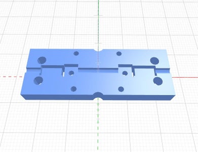

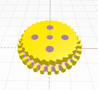

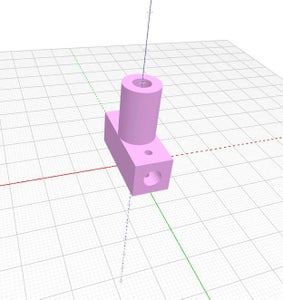

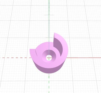

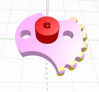

Step 2: CAD Design
The 3D printed elements were designed using BlocksCAD, with all sliced using Cura 5.8.1 and printed on a Elegoo Neptune 4 Pro.

Step 8: Motor Enclosure
A bearing with a 5 mm bore is inserted in the top of the motor enclosure.
This is a press fit and can be secure in place by pressing between the jaws of a vice.
Be sure to separate the support from the jaws of the vice with cardboard or something similar to protect the surfaces of the support.
Solder two wires (red & black), to the motor of 20cm each.
Feed these through the holes at the back of motor enclosure.
Press the front and rear halves of the enclosure together and secure with 2 x M3 x 15mm machine screws.
Feed the motor spindle through the back of the main support and orientate the arms horizontally
Attache the motor enclosure to the main support with 4 x M3 x 10mm machine screws.
Step 9: Pendulum Drive
A micro metal gear motor (1006:1 , 14RPM), is connected to a 7 tooth semi gear, the teeth only covering 110 degrees of the circumference.
Prior to the start and end of the teeth are semicircular cutouts.
These cutouts allow the pendulum gear (30 teeth), to disengage with the semi gear.
The pendulum gear is connected to the spindle of the pendulum.
When the motor rotates the semi gear rotates until it engages with the pendulum gear and lifts the pendulum.
The pendulum will continue to rise until the semi gear disengages at which point the pendulum will freefall.
A Hall sensor inconjunction with a magnet attached to the semi gear stops the motor once the gear disengages.
Once the pendulum stops the motor will be switched on to raise the pendulum.
Assembly
Align the holes on the flange connector with the holes on the semi gear.
Fit 4 x M2.5 x 6 mm machine screws in to the four holes.
Ensuring the collar of the flange connector is closest to the motor and tighten the collar screws to ensure a secure fit.

The pendulum consists of a steel tube the top end is attached to a T connector which enables it to be connected to the spindle.
With a 2.5mm drill bit open the 3 holes that will accept M3 x 8mm machine screws.
With a 3mm drill bit open up the vertical section of the T into which the steel tube of the pendulum wil fit.
Do not overforce the screws as they may strip the thread, split the plastic or in the case of the tube crush the body.

Step 13: Clock Face
The clock face is printed as a separate element this allows customisation and this is held in place by a minimum of two screws although many more screw holes are positioned around both if required.
In its current form minutes are at the top (5 minute intervals), and hours (1 hour intervals), at the bottom.
The numbers are printed slightly raised which enables them to the easily hand painted as there is a well defined area which contains the paint, any overflow would fall down the side rather than bleeding sideways into a connect area on the same level which would obscure the number.
Step 14: The Clock Mechanism
The clock is in the main 3D printed with a few exceptions, these being brass rods, bearing and screws.
The time is displayed on two faces the upper one minutes and the lower one hours.
A total of four gears are required for the clock mechanism.
Two single gears (60, [60 with raised pillar; hours]), and two compound gears ([15/60 minutes], [20/60 setter])
A separate spacer is required to be placed under the 60 tooth gear with pillar.
The gears are held in place between three tiers with the associated alignment holes.
The tiers are secured with M2.5 machine screws 10mm from tier 1 to 2 and 25mm for tier 1 to 3
Time setting is easily acomplished by rotating the exposed gear [20/60], anticlockwise which will rotate both hands.
Forward rotation is not available due to the rachet mechanism.
At the bottom of the clock mechanism is a tab which is used to mount the ratchet mechanism.
The assembly sequence is shown in the supplied images.

The two compound gears require a 3(dia) mm brass rod inserting in the centre hole, first open the hole with a 3mm drill bit and pressfit the rod into the centre with a pillar drill using a flat faced rod in the drill chuck.
The 15/60 gear requires a 47(L) mm rod.
The 20/60 gear requires a 37(L) mm rod.
The single gear 15/60 requires a 3(dia) x 37(L) mm brass rod.

Step 15: Escapement Pt 1
The escapement is assembled as two main parts.
The first part consisting of a ratchet and pawl mechanism with other associated elements.
The ratchet gear has an integrated 30 tooth gear that interfaces to a single 60 tooth gear in the clock mechanism that drives the clock.
There are two pawls one locking and one driving.
The driving pawl is operated by the action of Escapement Pt 2
Some prepartion and assembly of the parts is required prior to use.
Locking Pawl
The locking pawl requires two holes to be opened out the centre hole with a 3mm drill bit and the off centre hole with a 2mm drill bit.
The hole were the other end of the spring will be attached should also be opened out with a 2mm drill bit.
Attach a 10mm extension spring with a 2.5mm machine screw to the off centre hole in the pawl.
In the location of the supporting body which aligns with the slot in the pawl open out the hole with a 1.5mm drill bit and press fit a 2mm x 10mm brass rod into the hole.
The pin can be inserted using a vice or pillar drill to press it in place.
A similar pin should also be inserted at a point at the lower right hand edge of the ratchet gear.
Place the slot in the pawl over the pin and fit the pawl in place with a M3 x 10mm machine screw and plain washer.
Do not over tighten the M3 screw as the pawl needs to move freely.
Attach the other end of the spring in place with an M2.5 x 10mm machine screw.
Driving Pawl
The driving pawl required 3 holes to be opened with a 2mm drill bit at holes 1, 4 & 6.
On to a M2.5 x 10mm machine screw slip one end of a 0.3x3x10mm spring and insert the screw in to hole 1 of the driving pawl. Repeat the same process for hole 6.
The lever requires 2 holes to be opened up with a drill bit, 3mm in hole 1 and 2.5mm in hole 5.
Fit a 2.5mm x 10mm machine screw in to hole 5 of the lever and secure this in hole 4 of the driving pawl.
Ensure the pawl and lever turn smoothly.
Place the large opening of the driving pawl over the brass pin.
Secure the lever in place with a M3 x 10mm machine screw.
Secure the free end on the tension spring with a M3 x 10mm machine screw in the hole nearest the lever fixing screw.
Secure the free end of the return spring with a M2.5 x 15mm machine screw in the last hole in the main body.
Testing the Escapement
Fit the ratchet gear between the pawls and secure in place with a M3 x 25mm machine screw.
Push the bottom of the lever forward.
This should move the gear round one position.
With tension spring keeping the driving pawl pulled towards the ratchet.
The locking pawl should be moved out of position then spring back into place preventing the gear reversing.
When released the return spring will pull the driving back to its start position.
There are addition holes on the main body to enable some adjustment, such as shorter springs.
The ratchet gear will need to be removed prior to fitting the clock mechanism.
Fit the Clock
Slide the tab on the clock into the cutout on the Escapement 1.
Refit the ratchet gear.
Check to ensure that the ratchet advances the clock 1 minute per step..

The second part of the escapement is much simpler and consists of a pushing arm.
This part consists of 5 main elements
This arm is used to convert the radial motion of the pendulum into forward motion to activate the driving pawl.
The catch of the arm is positioned such that the pendulum makes contact just short of its maximum elevation.
If it is positioned much lower than this there is plenty of push but it can cause the gears to slip and affect the timing.
*The alternative is a slipping/clutch gear which protects the gears and motor making setting less critical.
I have not applied the slipping/clutch gear on this version.
With the longest piece orientated vertically and the side arm facing left.
Hole 1 at the bottom of the arm should be opened out with a 3mm drill bit.
Hole 8 up from the bottom should be opened out with a 2mm drill bit.
Holes 11, 13 and 23 should be opened out with a 2mm drill bit.
In to the 20mm spacer open out the hole with a 2mm drill bit.
Attach the catch to the spacer by its centre hole.
On the short left arm at the most extreme left (hole 1), open out the hole with a 2.5mm drill bit.
On the separate short piece (6 holes), with the piece orientated with the thicker sections to the right with a 2mm drill bit open out the two holes at positions 4 and 6.
Align the short piece (holes 4 & 6), to the longest piece (holes 11 & 13), and fit this to the back of the longest piece such that a ~5mm gap exists between the two parts and secure with 2 x M2.5 x 10mm machine screws.
Attach the cup to the side arm at hole 1 with a M3 x 6mm countersunk machine screw.
Attach the catcher to hole 23 of the longest piece with a M2.5 x 15mm machine screw.
Support Arm
The support for this arm has a curved slot and four horizontal hole at the front.
With the slot orientated at the top and the check the fit with a 2.5 x 15 mm screw and ensure it moves freely.
In to the third hole (hole 1 on the extreme left), open it out with a 2.5mm drill bit.
Attach hole 1 to the support arm at its 3rd hole with an M3 x 12mm machine screw and plain washer (sitting between the arm and support).
The support sits at the right hand side of the platform.
Step 17: Assembly
To the ledge bracket insert the two pendulum support tubes.
Screw the main support with attached motor support and motor sensor to the ledge bracket.
Attach the clock support and Escapement Pt 2 to the ledge support.
At this point securely attach the ledge support to a table or bench with gclamps or ratchet clamps, ensure they will not catch on the pendulum.
